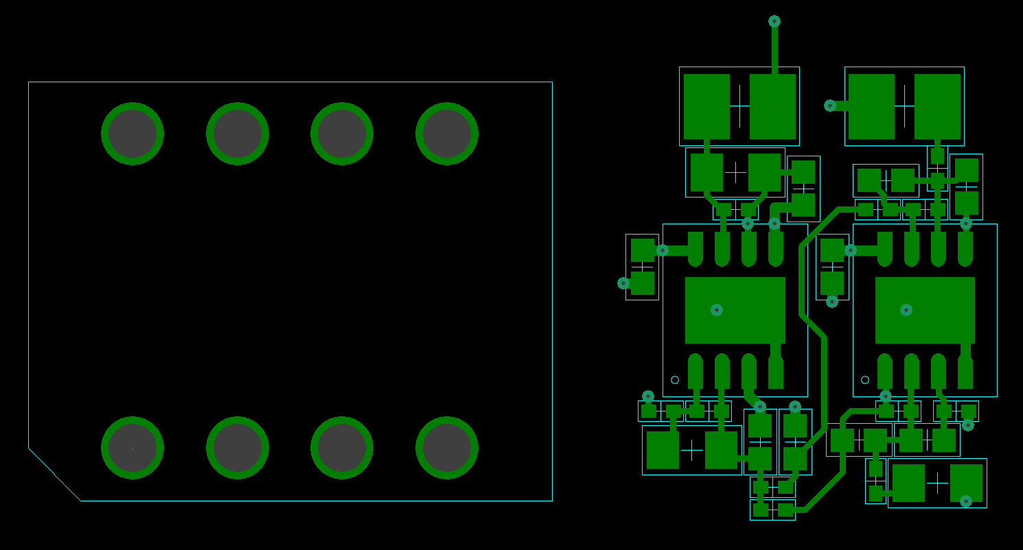

Gee I'm a bit disappointed you cant share some of the sophisticated layout techniques with us amateurs, I only do simple using designs techniques like this quite often these days:

Just for your interest (and as you love op-amps) here's some 21st century SMD analogue next to an 0.1" pitch 8 pin DIL, the opportunities for small compact sensitive analogue layout with minimal parasitics and minimal EMC target area is readily available these days, with advanced thermal engineering you can also keep the whole assembly cool, minimising thermal distortion,🙂
So I actually have a professional interest in the Blowtorch layout, and have a curiosity as you all went to the expense of using a Teflon based substrate, what else you did...

It what I do for a living John, and have done for over 27 years. In fact when it comes to PCB design I am probably a bit of a geek, as I have a deep interest in all aspects of design, manufacture and assembly issues, and I am always interested in how others do their designs and the reasons why. As to analogue layout, most small signal layouts involve ground planes, sometimes one contiguous plane, sometimes separate GND pours for different sections with a starpoint, and often with outer layers GND poured and used as a dirty EMC ground on the outer layers, often routed directly to the chassis. Low noise circuitry requires careful layout, that's one reason I like the new generation of packaging, HDI PCB layout etc, the new packaging is very thermal efficient, a necessity with the amount of stuff that gets crammed on some boards these days.

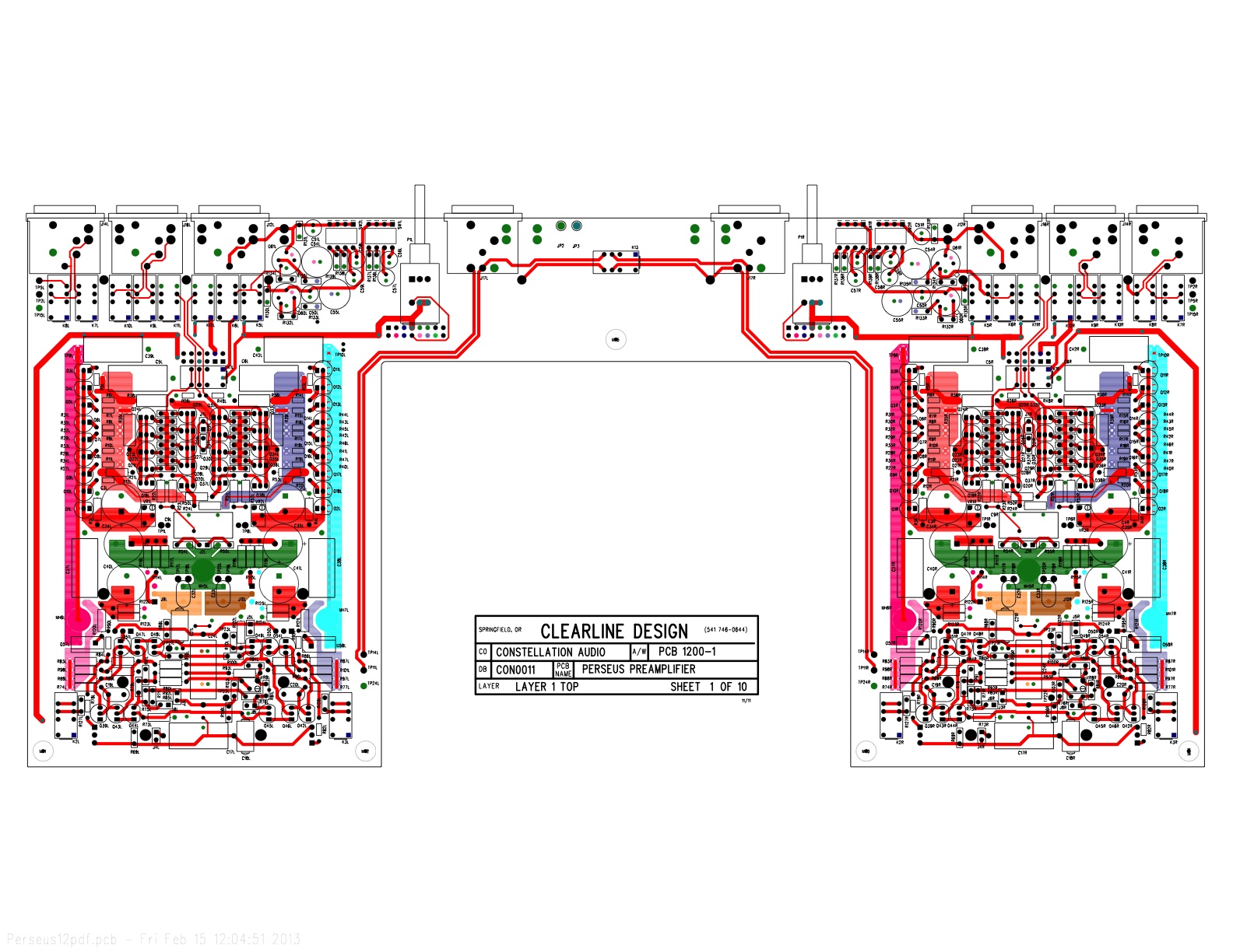

The latest technology is really crowded with 6 and 8 layer PCB and chip scale packages. But they have very little exposed analog. I have been working with a PCB with a Bluetooth chip and 2 full DSP's plus antenna in less than 1 square inch. We could shrink it more if we put parts on both sides but that has consequences. Despite all of the connections (6 microphones, USB and RF) there is very little analog that is not in a chip. Which also means little opportunity to make it better.
The constellation board is much denser than other discrete boards using that generation technology (really, late 80's and early 90's). Surface mount makes for much smaller footprints, but the "good" parts are unavailable in surface mount if at all.
The IC argument will pop up and it's true, the functionality of that board could be accomplished in smaller space with IC's but one real limitation on IC's is dynamic range. Even really low noise IC's are still limited in output swing. Going discrete can permit much higher voltage rails and more max out.
Thanks Demian for your input. All I know is, NEVER AGAIN! Any board that I have to troubleshoot in future will be more optimally layed out for symmetry and ease of identification of the individual components.
Don't worry Demian, I won't show the other layers or the bottom of the board, even though it has a bit of surface mount.
Demian has more experience in 'troubleshooting' this board than I do. Trust me, it is a 'headache' not just because of the schematic, but finding the individual parts and measuring voltages, as well as replacing them.
This board has been a hard lesson for me, as I only approximate the specific resistances in a design and once a prototype board is made, I optimize the entire circuit. The difficulty of changing the resistor values in this schematic, as well as the surface mount changes has caused an embarrassingly high amount of trouble.
I guess, in future, I will have to computer SPICE modeling, before making anything. I never had to, before.

I do welcome the ubiquity of surface mount as it allows us to do low-volume designs that come near to integrated performance by reducing parasitic inductances etc. And even changing out parts, once one gets the hang of it, is in some ways easier than working with leaded parts and plated-through holes --- at least with 0805 or thereabouts. Much below that gets tough for manual assembly without specialized equipment.

A problem also for redundancy, for equipment that has to run 15 years or more, trying to get a circuit to work the same today with new parts causes engineers headaches, on the same note, see a lot of older designs coming in to have EMC components added to I/O specially to cables.
Well, layout is NOT my thing. I leave it to others, people who have a proven record. We only miniaturize circuit boards when it is absolutely necessary.
Surface mount has a VERY LIMITED selection, these days, for my circuit designs, at least.
My biggest headache is CASES. It is difficult, if not impossible, to make a case that is attractive (at a world class level), cost effective, and useful as a shield, enclosure, heatsink, and stable platform for switches.
Most of the time, these days, I leave the CASES to others who I consult for. They do a pretty good job at making the tradeoffs, if necessary.
I will stick to fundamental analog design, with or without IC's, leave the board layouts to Carl, and hope to improve my troubleshooting skills, that have declined since I have aged and lost an eye. I sure wish there were some skilled techs or jr engineers who could do the things that I once had to do, when I was younger, and save myself as an overseer of the circuit design, rather than have to do the mechanics of it. I can still read test results easily enough to optimize the circuitry.
Unfortunately, there are many here, especially the vocal ones, who believe that design efforts, like my own, are redundant, and a waste of time. Fortunately, I do hear from others, who think differently, and I still hear differences in IC's, preamps, power amps and EVEN cables (at times), that tell me I am still on the right track. I'll just 'keep on truckin'. '-)

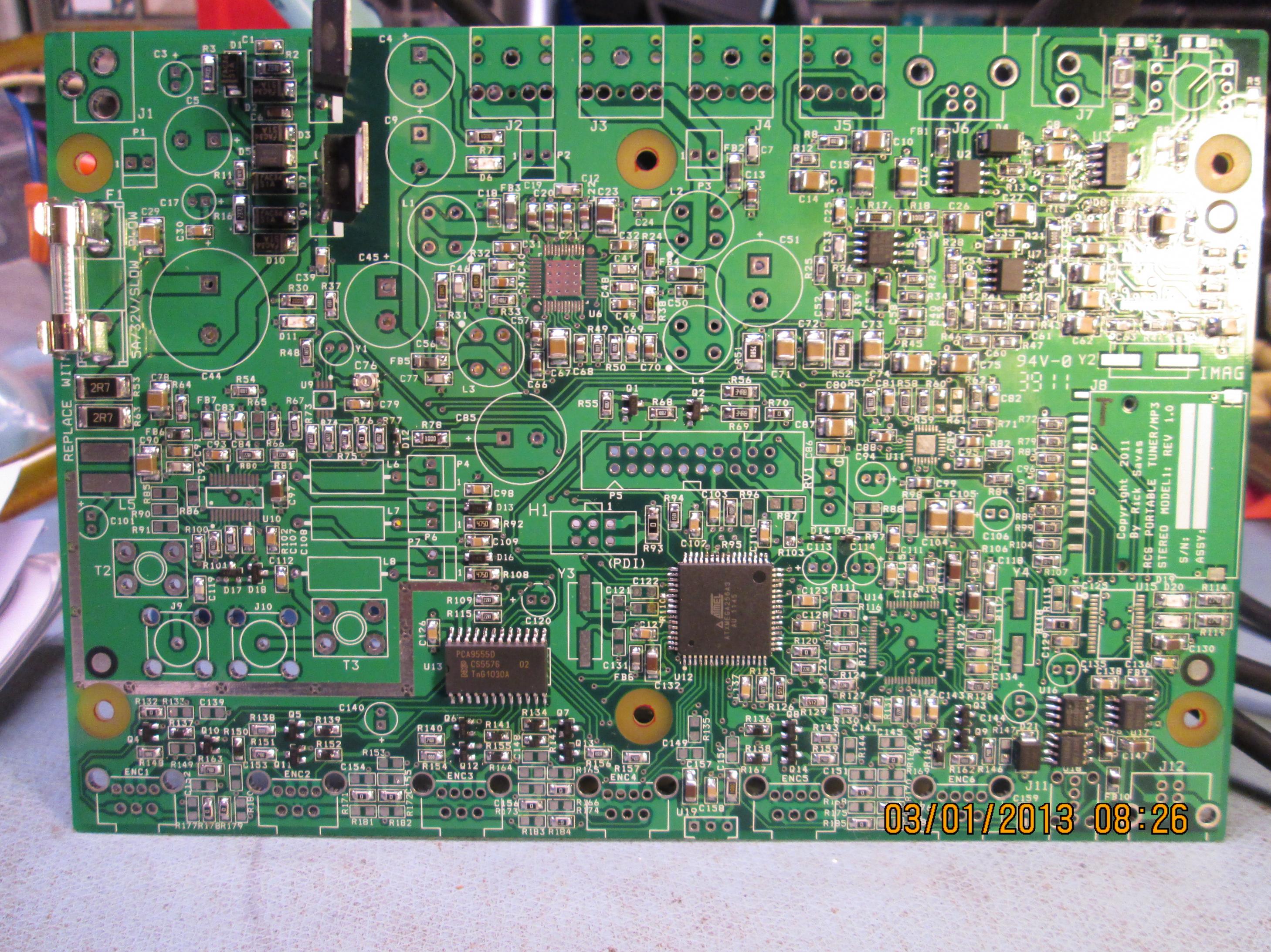

This is what we call a 'crowded' analog board.
Maybe in the days of old, but not by today's standards.
Layout is fun for me, especially if I am not under any schedule pressures.
Layout brings lots of challenges to a designer. It really sucks when you have to do it again, for one reason or another, kinda have to allow for at least two rev's before Mfg Release. I remember back at HP, the average was a between 1-2 pcb rev's, which is darn good. One design that we did had a brain dead ASIC on it, I did 6-8? pcb rev's before MR release, made lots of OTime$ on that project. A mass of FPGA's on it to fix the prob.This was done using Mentor BoardStation.
In this latest design, "Portable Media Player" I have done, as shown, a mixed signal design. Tuner(Si4735), MP3/WMA/AAC memory stick player(BU9458), USB CODEC(PCM2902B), headphone amp(MAX9729), 25W Class "D" amp(TPA3100D2). Amtel ATxmega MCU. This done in ORCAD.
It blows me a way, that I can do the same & a whole lot more in this small form factor than an ole receiver. I look at my old Pioneer SX-950, still selling on eBay for almost the same, I paid for it in 1978 and get a chuckle.Okay this portable ain't a 100W/ch Class "AB" amp, but for the majority of your listening it is fine.
Right now I am listening to Van M, playing the CD in my computer, through the USB to the portable, on to my Dynaudio Gemini's, the sound is great and this all that really matters. I am drawing about 3W idle. Maybe double if I crank it.
I am an advocate of jamming as much functionality into a small package as possible, considering this is a design for my own use.
This is what I call AudioDIY for myself at least, say compared to what I did for a college project 30+ years ago.
Anybody interested in one?😀 Assembled or bare pcb? Just kidding, I know this ain't the commercial section. Actually I need more help with SW than HW, of late.
