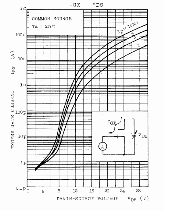

Joshua, please note that the graph starts about 8V. That is the 'breakpoint' of many jfets.
Here's a little better illustration:
