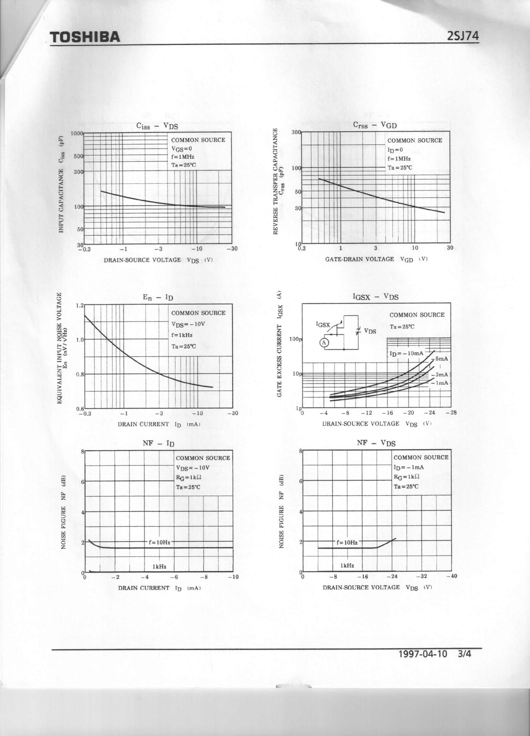

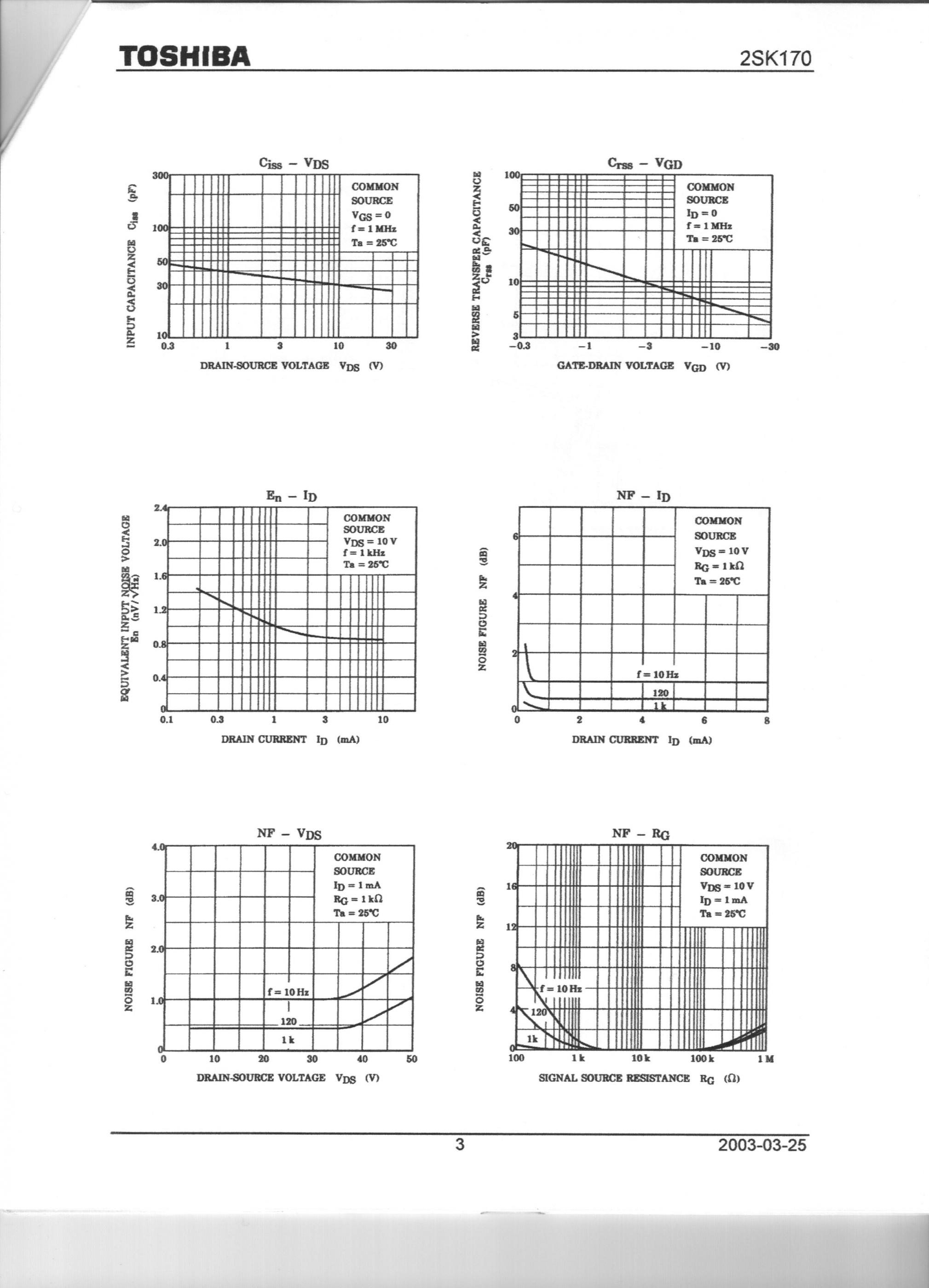

Thanks JC and SY. I run some sims for DL-103 with 3 to 1 variation of C. Results agree with SY calculations. I wonder then how can the nonlinearity of the input capacitance can have an effect in the audio band.
It turns out that it's difficult to extract the nonlinearity from the published curves. But it's easy to show that it's absolutely insignificant. If we assume that there's no cascoding (which, as has been helpfully pointed out, nearly eliminates the variation of Cin with signal), assume 5V Vcb, and assume 40dB first stage gain, the variation of input C for a 2N4401 is about 0.14pF for a 0.1mV input. Whether linear or not, that's hilariously low.
John's argument about nonlinear input capacitance does not seem to be well thought out.
No SY, it is not 'well thought out'. And there is no SPICE simulation either. No, I just build successful designs and measure them at high levels and high frequencies to see if there is any extra distortion from secondary sources such as non-linear capacitance. Then I build hundreds of them to be enjoyed by users around the world. Works for me! '-)

The non-linear input capacitance is a moot point, because it takes about 1Kohm or more to even measure it with the devices used. Since the SCP-2 never sees more than 50 ohms source impedance, I am in safe territory. Second, it requires graphical inspection of the non-linear input capacitance to initially determine if there will be any problem. It might be noted that the Vendetta stages are DELIBERATELY operated in the most linear region with regards to non-linear capacitance.
Third, I took care, decades ago, to measure the distortion at frequencies from 5KHz (my normal standard) to well beyond 20KHz. IF I had seen a significant departure from the Class A predicted distortion curve with level or frequency, I would have fixed the problem, or at least known there was a problem. I just did not want to put up the graphs on the devices, at this time. Maybe later.

I asked a very basic question about phono stage design- why an FET rather than a bipolar for the first stage of a state-of-the-art unit. So, based on reality rather than stories, why an FET rather than a bipolar for an MC input stage? So do you actually have a technical reason which stands up to basic analysis?

Now, for the non-linear capacitance issue:
Here are two complementary devices similar to the devices used in the Vendetta. Just multiply the capacitances by 2.5 or so and you get the original devices. Similar curves I believe. Note that I operate the input jfets at 9-12V either Vds or Vdg.

Yes, John, I used those graphs for both the FETs and the bipolars to determine that the nonlinear capacitance claim is nonsense. Perhaps you want to take a moment to run the numbers about linearity at 10mV collector/drain swings before making your next set of claims? Or is this an ex cathedra exercise rather than engineering?
