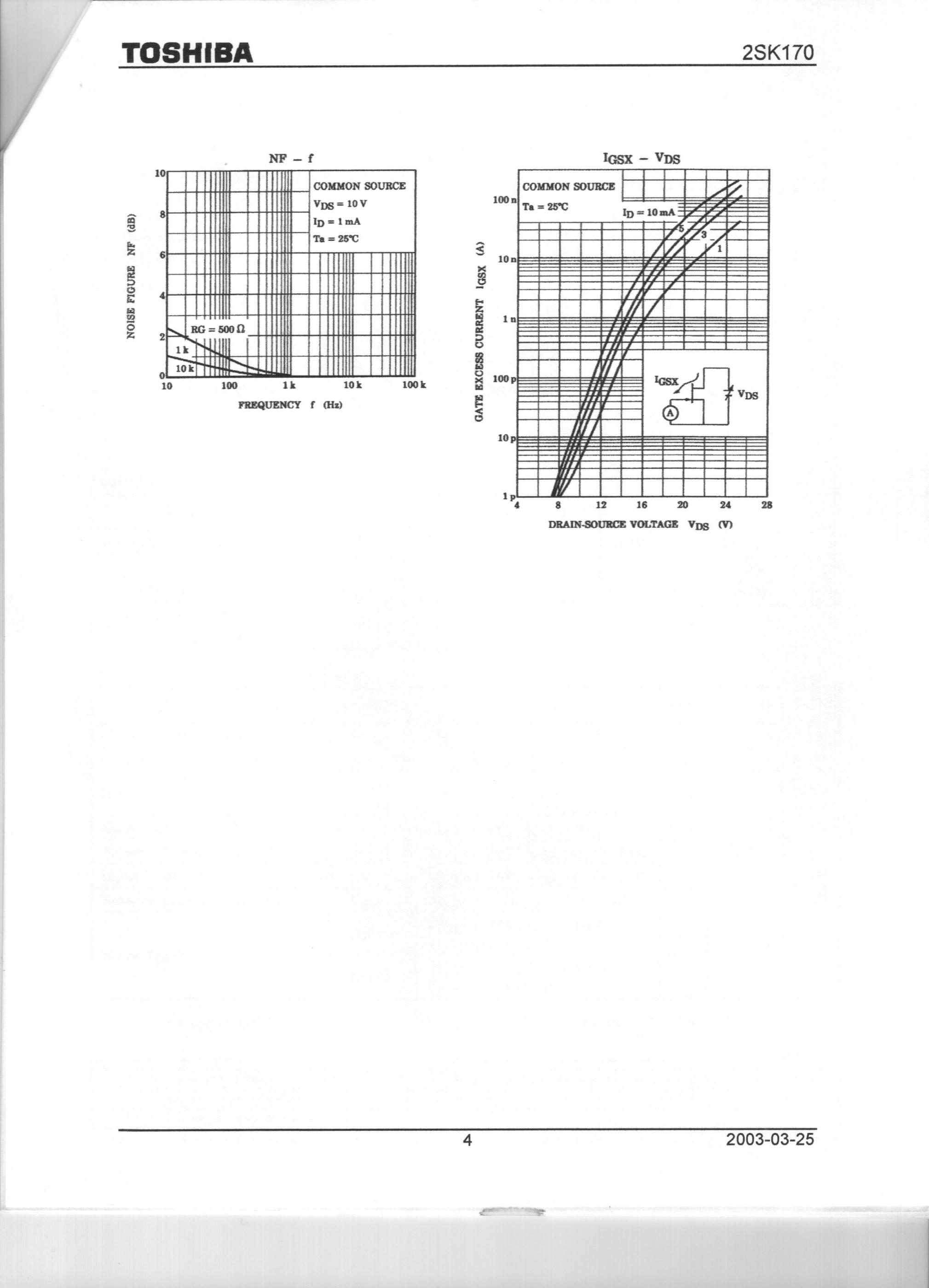

Hi John,
Why multiply by 2.5? Is it the difference in the input capacitance between the devices used in the Vendetta and the 2SK170/2SJ74?
As far as I remember, from what you wrote few years ago, the equivalent input noise voltage is lowest at 8V Vds. Is that correct?
Is the 10V Vds a compromise between noise between noise an nonlinear capacitance?
… Here are two complementary devices similar to the devices used in the Vendetta. Just multiply the capacitances by 2.5 or so and you get the original devices. ...
… Note that I operate the input jfets at 9-12V either Vds or Vdg.
On the nonlinear capacitance curves, note the rate of change of the slope at about 10V. That is why we like to operate around 10V, because it is more linear there.

That's fine. Here, this is a technical forum, not an audio show. If you don't want to answer technical questions using technical arguments or data, that's fine too, that has its own clarifying nature.
You 'think too much' Joshua. It is more simple than that, fet input noise is not directly related to Vds, but IF you go too high in voltage, gate leakage will become noticeable.
You are referring to what I said about microphone preamps with 1 billion ohm input vs 10 ohm input for a MC preamp, you know, 100,000,000 : 1 ratio. Once you get to perhaps 15V with a 10 ohm input, then maybe something might be detected.
Have you read the datasheets?
