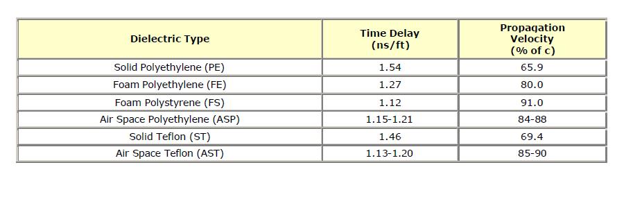

Roughly 1ns/ft for a signal. Insulation can move that up or down a skosh.
Do you think you can hear a difference between a 10' and an 80' speaker cable?

That will depend on the characteristic impedance of the line, the impedance of the load at the specific frequency, the length of the line, and the impedance of the source at the specific frequency.And how much cable length is required to introduce a delay of 1 uS?
At very high frequencies, the line to load mismatch will cause delays in the 5 to 10 uSec range as long as the amp output is sufficiently stiff. If the amp is incapable of correcting the reflections as they occur, the settling time will get worse.
At lower frequencies, the R of the cable will make the situation even worse.
If you want to see the delay and the reflection, just use an HP8721A.
Within a coax with a dielectric relative permittivity of 4, the prop velocity will be half lightspeed, roughly 2 nS per foot. For zip, this is a useful rough value, but thicker insulations can increase this to almost 3 because it spaces the wires farther apart.
