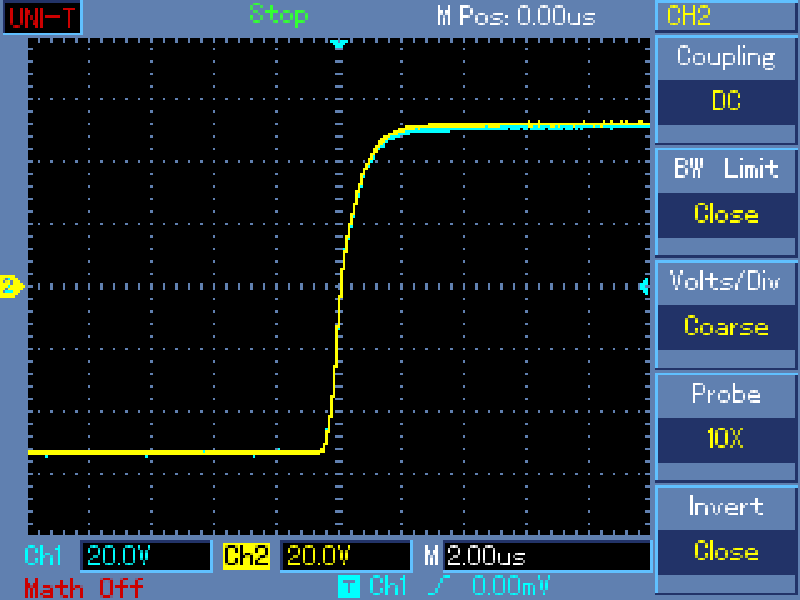

Vladimir, how does this story look if you limit the input signal to say 20kHz or 25kHz? See attached. Start with a 'exaggerated 10uS rise time input, 1st order roll off at 25kHz to simulate audio signal.
Put that in your amp, and look at the ringing.
I won't even get started why you think a well-designed audio amp should have 5uS settling time...

Yes Jan, these stories here are funny, funny and nothing but funny. Please let me attach a step response of the 250W/4ohm power amplifier, with the evil Global Negative Feedback. 106Vp-p voltage swing.

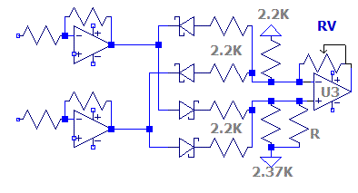

I'm stuck with a little stupid problem, you know how it is.
it is absolutly out of topic, but there is the place where i have more luck to find clever people 🙂
U3 sum double full wave rectifiers and amplify the rectified signal. It works fine, but the + & - signal balance is affected by he RV value, so R need to be finely tuned for each value of RV. (giving R the same value than RV, between 10K and 1Mohm)
Any idea to get rid of this without adding an other OPA ?
