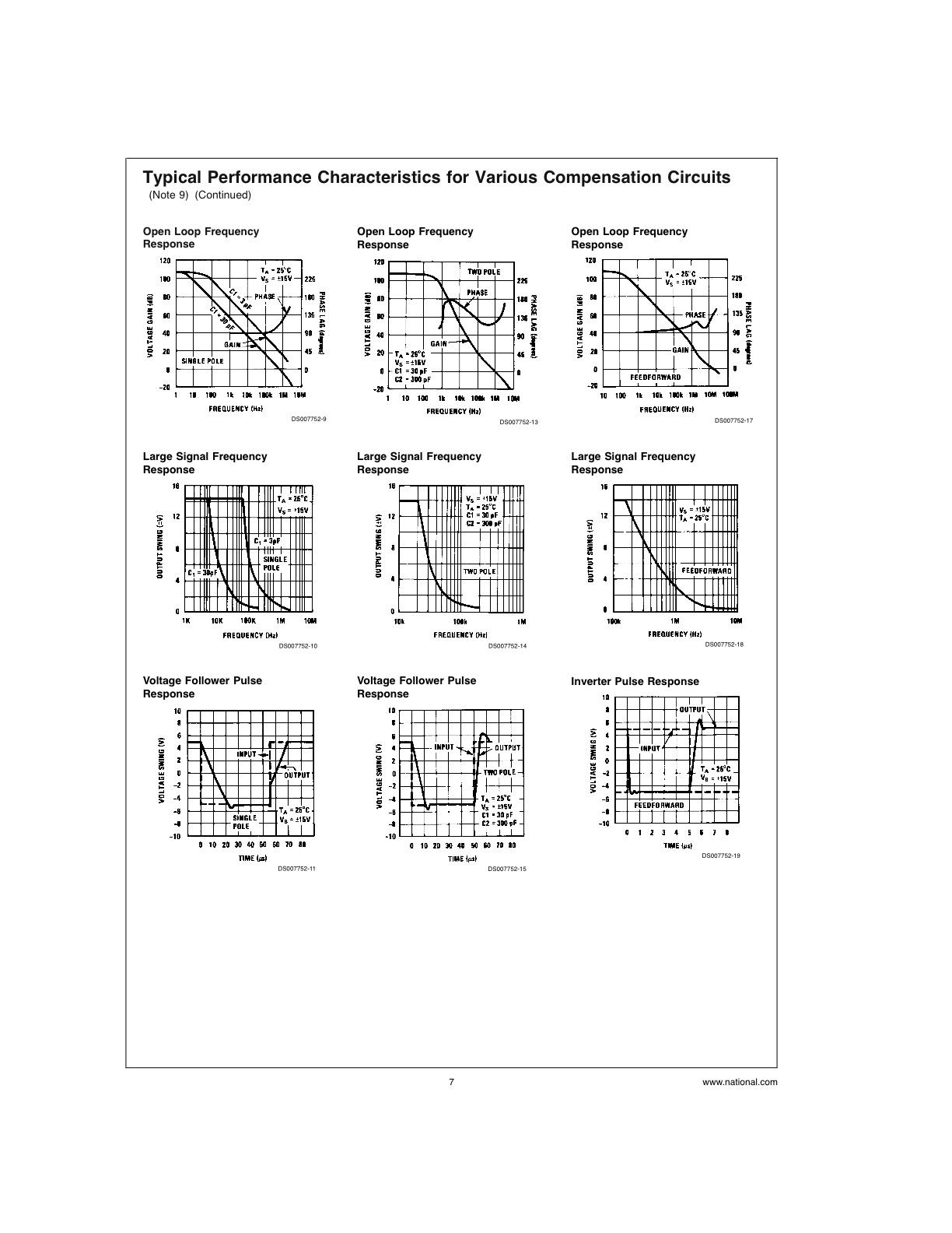

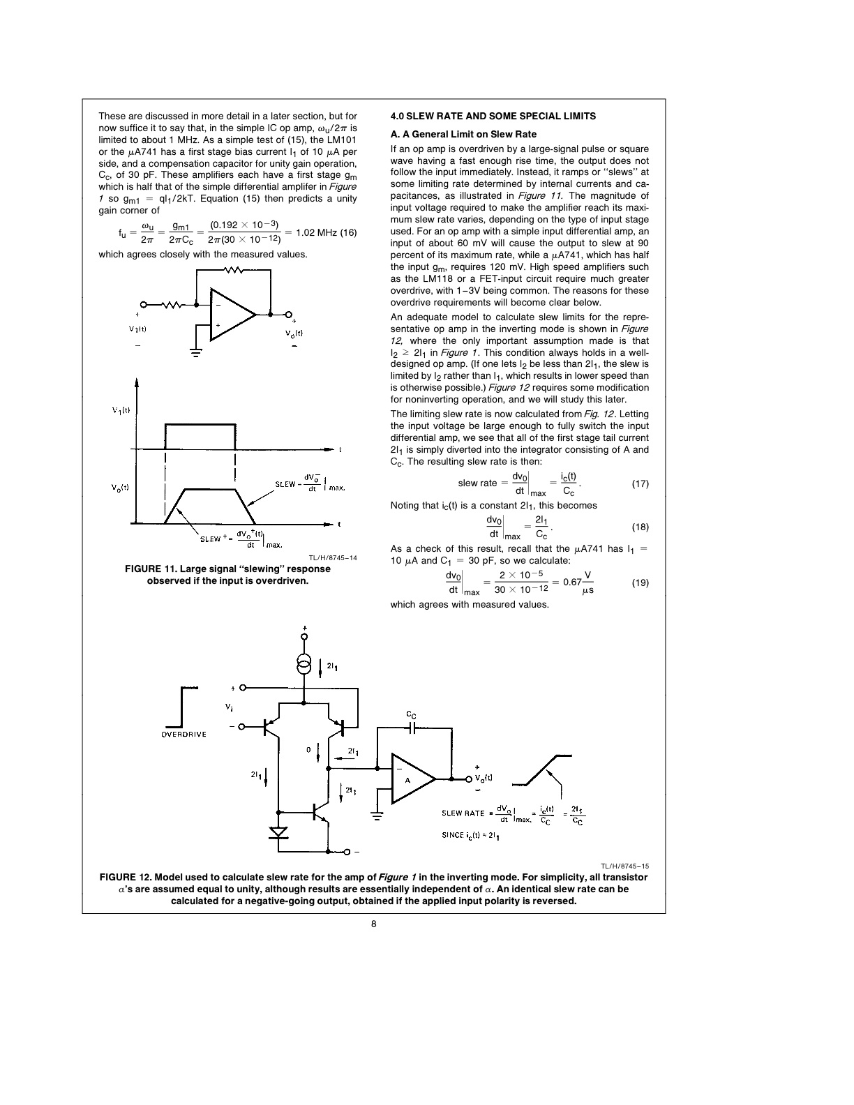

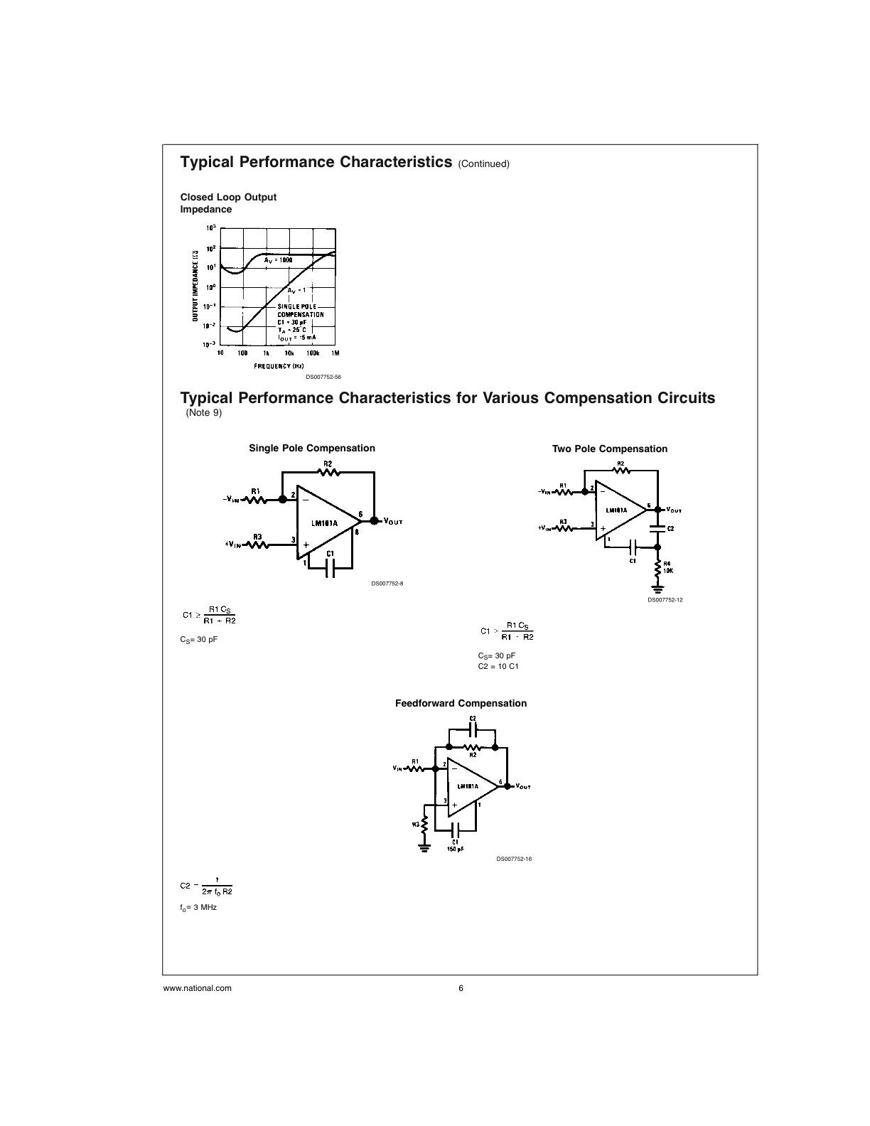

When linear IC's were first being designed by Bob Widlar, they lacked the comp. cap that had to be added, depending on the gain setting. 30pf? Not necessarily, perhaps something smaller with a gain of 10 or 100. This was BEFORE the uA741, a part designed for SERVOS, primarily, and the uA741, given its convenience, came to dominate the entire industry. Once, we all decided that we normally wanted an internal compensation cap, then we were stuck with the lousy slew rate of the uA741 for almost all applications.
However, we could, in theory, operate its predecessors, the LM101 or the uA702 or uA709 open loop, if we wished to, at the time. Maybe somebody did, but they were NOT designed for that operation, but for global loop feedback. So when many of you were in 'grade school' we designers had to be shown WHY we had to use a dominant roll-off to avoid oscillation with global loop feedback, and this was part of the original app note explanations of these new devices.
Today, many of you have never had this 'choice' in circuit design, so you take the comp cap for granted, BUT it is the PRIMARY source for slew rate limiting. A large output load capacitor is a secondary source, and it usually does not come into play, except for vacuum tube RIAA phono preamps, or OP Amp integrators.

Feedback IS a necessary factor to give normal slew rate limiting. The op amp is a perfect example of worst case slew rate limiting, in principle.
VFA opamps user Miller comp because its the easiest most convenient way to create an unity gain stable system with a small single monolithic cap. There is nothing worst case about it at all. And with slew rates on modern devices >15 or 20 V/us, they hare hardly going to have problems with any kind of music material in the small signal domain. And, if you are still concerned about it, you can use a CFA topology opamp.
With power amps, MIC or other 'non-slewing' comp schemes make a bit more sense if you are targeting something greater than say 100V/us but even here there is nothing to say standard MC cannot get the job done just as well. I am doing 155 V/us on my e-Amp Ovation e-Amp
