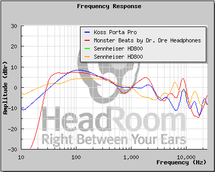

So Christophe,
What you are showing there is that we are doomed to mediocrity if we listen to any of these headphones? I guess I can just put two transistor radios on a coat hanger on my head and get this kind of sound. 😀

If I recall correctly, HD800 is diffuse-field equalized, so there is a reason for the particular frequency response. Every pair ships with a graph showing deviation from the "ideal" response.
Headphone response is very complicated by the ear-phone interface. The in-ear phones are much easier to measure, the "cans" much tougher and subject to much interpretation of what constitutes typical pinnae etc.. There are some good discussions here and there, and there is still a fair amount of controversy iirc. A good start is Poldy's lengthy chapter in Borwick ed. Loudspeaker and Headphone Handbook, ISBN 0240515781 for the third edition.

Hum... I just wanted to show how it is difficult to measure an headphone response. Need to compare several to get an idea of the measurements errors (common peaks between severall).So Christophe,
Even on your ears, the slightest change of position greatly change the response.
It seems that, apart a little excess in medium basses, and a little accident in medium, the cheap and nice Porta Pro is one of the best for few bucks, and the Beat obviously the worse..
I have top old AKGs, Sennheiser and Koss electrostatic at home, no one is perfect, and at least, the Koss Porta Pro is the one i prefer on daily use once equalized at 100 & 7000hz 🙂
I have too an old Stax, very analytic, found-it not musical for my taste, i hear the membrane..
yeah HD800 arent as bad as it looks in the graph, I cant hack them anyway, due to peaky/piercing treble (sibilance is too kind a word) and impossibly large 'soundstage' unrelated to the recording, but headphone curves take a bit of getting used to, to look at.
beats are a travesty though, theres no way to put positive spin on their response and no way to do anything about it with tuning your amp, since they use onboard active 'equalization'

Take a look at that FR posted by Esperado: I don't see hot mid/treble in that. Just about every speaker response shows more elevated mid/treble than that ...Frank: i've got some pretty wide experience with headphones, I work in the field, modifying and repairing the most expensive and vintage headphones on the market is part of my living. intimate jazz does not take place in a superbowl, hot treble/upper mids, is hot treble/upper mids and their boosting is a common technique to give the illusion of more detail. HD800 are fairly well known for these artifacts and I dont disagree.
Yes, I know that the responses are peaky -- every response curve, of the "best" headphones, I've seen looks a roller coaster mess, and differs dramatically from other, highly regarded units -- so what dictates a good headphone obviously is more than simple response curves.
