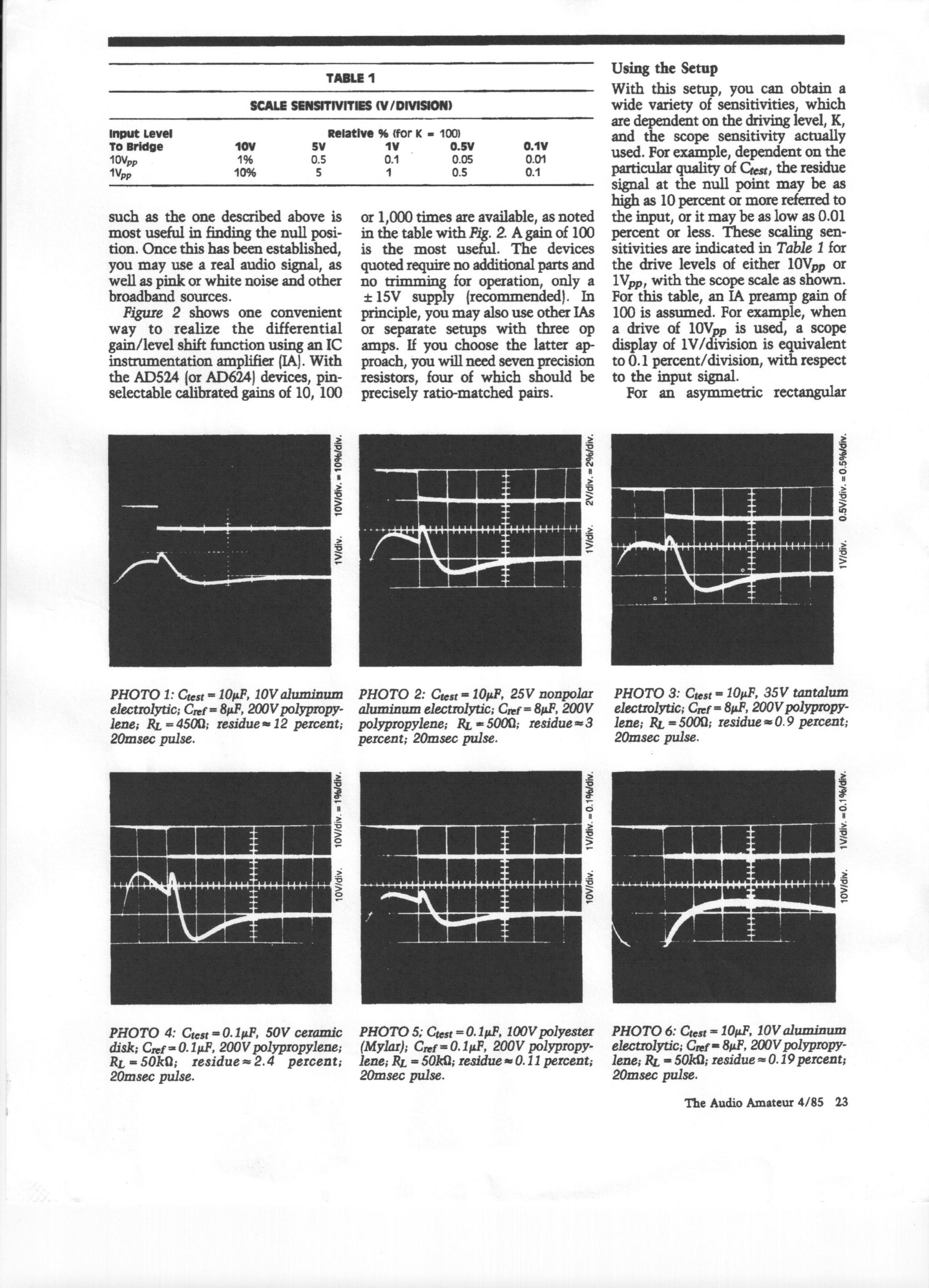

Thanks, PMA, an excellent example. YET, that sort of waveform is necessary to bring out the DA in caps. An example: Look at the top waveform, it is asymmetrical too!

The test signal was adapted to MAXIMIZE the lowest signal frequency (fundamental) that would normally be passed through a hi fi system.
Of course, at higher frequencies the DA effect is reduced, but it still remains. I like reasonable worst case, rather than 'babying' the component under test.
