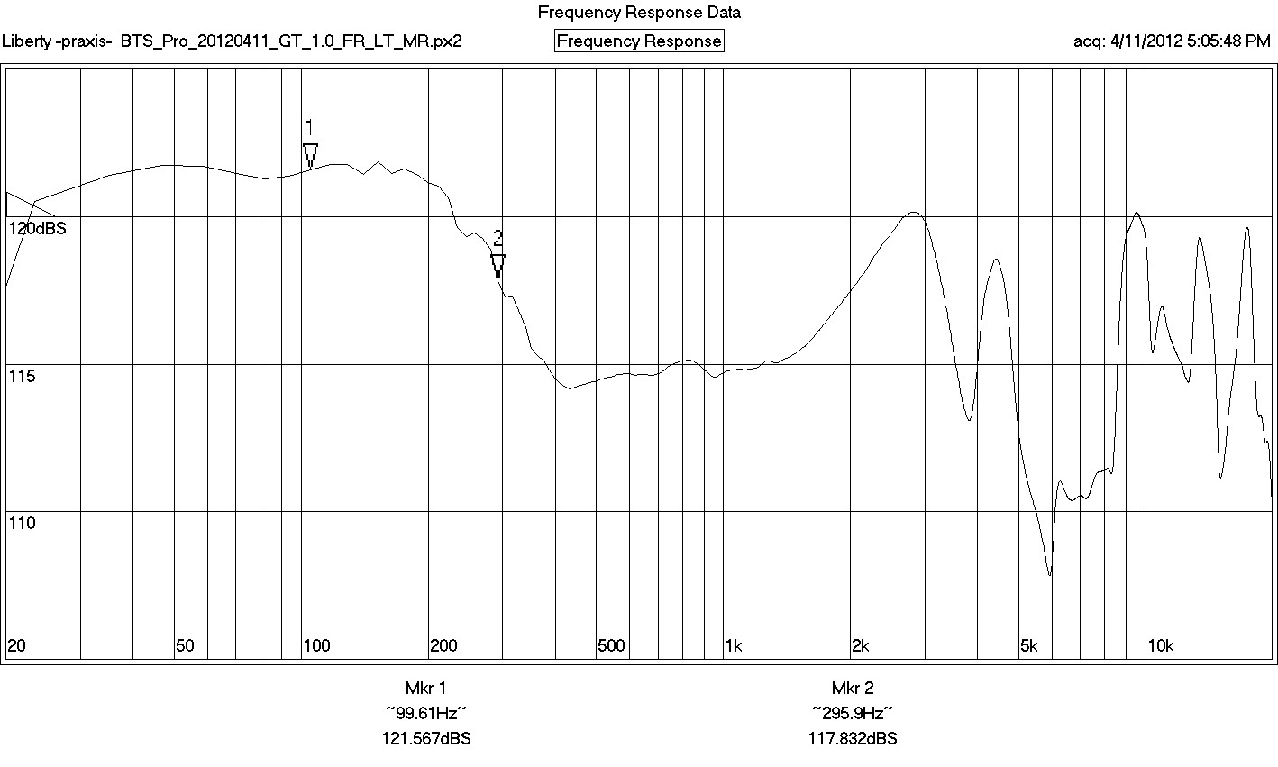

Which system was that measured with? I don't see the characteristic resonances at 12 KHz or so of a 711 coupler.
Attached is a typical measurement using a GRAS artificial ear of an early Beats Pro. Most of the Beats headphones have the characteristic depressed midrange. That is part of their signature. The boosted bass as well, essential for the hip-hop scene.
There are valid arguments for the balance and different target curves but they are meaningless one way or the other when compared to the sales figures for successful headphones. The curve shown sells. Every serious audiophile in the world could buy a specific headphone and that would not keep the line running for a week.

The problem I have with the concept of making these headphones work for Hip Hop music is you are taking a music mix that is already heavy in the bass, lacking in mids and nothing but synthetic highs from a keyboard and doing the same in the headphones own curve here. Making a bad mix even worse. So you are saying that any other music will sound like hell on them, this I can agree on after listening to multiple different models. The industrial design is nice but the sound quality isn't any better than a $5 computer loudspeaker really.
