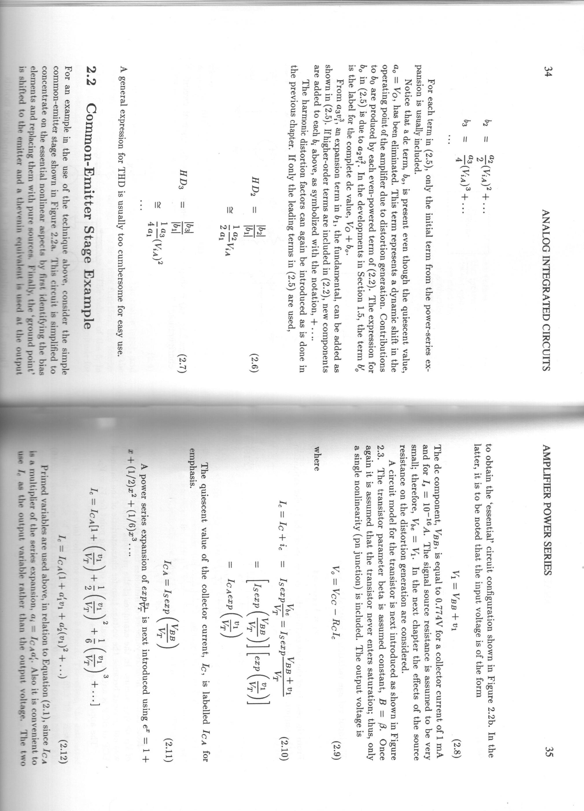

Even harmonics are present when waves are non symmetrical. Such an asymmetry adds a DC component.
George
No! There is no way to add pure sines and cosines algibraicly to create DC. There has to be explicit DC present or modulation/non-linearity.

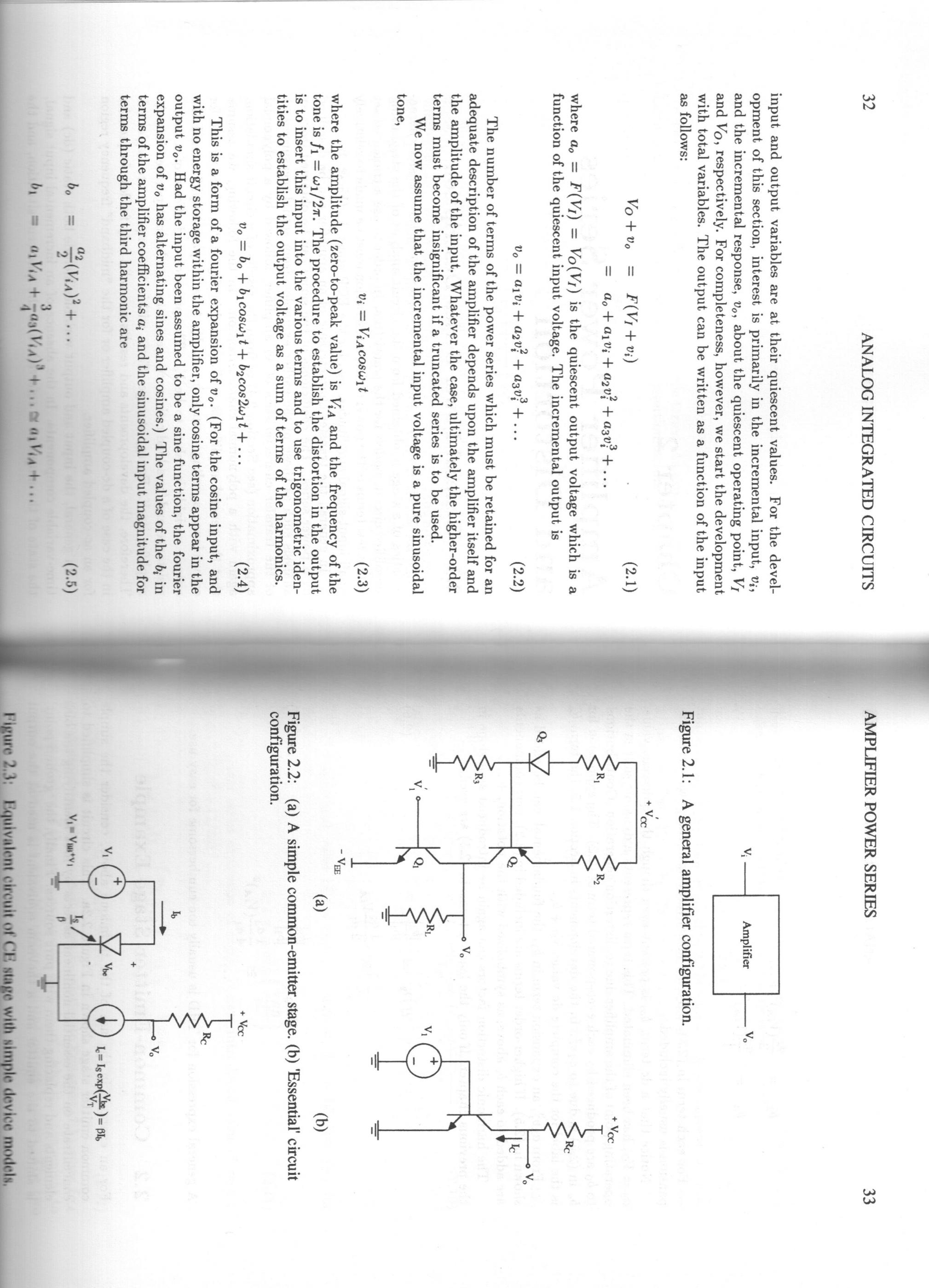

Go to it, Gapapag. I'm too tired to correct Scott of the DC offset thing.

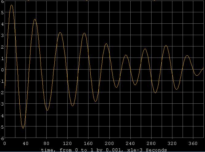

Just a few terms start making an "asymetrical waveform", I could add more and get it even stronger. There is NO DC here. What are you trying to say, that you can add terms of sin(awt+phi) and get a DC value? Or maybe you can highpass filter a waveform and retain the DC component?

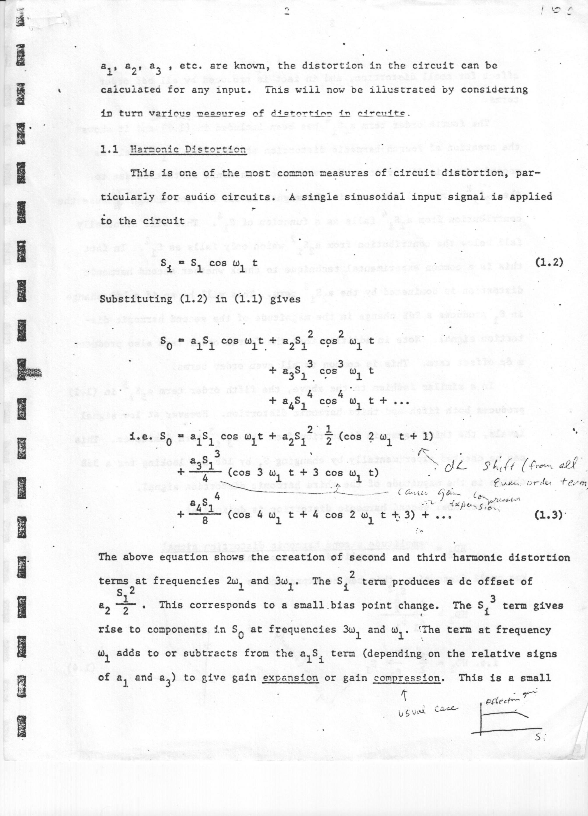

More info from the original class notes that the Pederson book is based on. Thanks to Ron Quan for giving me a copy after my originals were destroyed more than 20 years ago in a firestorm.
OK, I will put the text up: Look at B(0), where B1 is the fundamental.
You're putting waveforms through a non-linearity, you obviously don't understand what I'm talking about.
