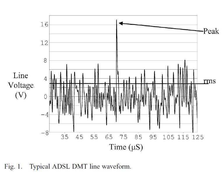

Not the same waveform, I would consider a diode a pretty gross non-linearity causing modulation products that are not possible by simple linear addition. You square a sine wave and you a second harmonic plus DC no simple addition of sine waves of any frequencies will give the DC component.
EDIT - Here's a previously published example, this waveform has no DC and is highly asymmetric.
Scott, this example only proves what I already thought. Ofcourse there is no DC here. How could it be after galvanic uncoupling? The zero floats.
I thought all waveforms could be produced by simple additions of sinoids, including those caused by diodes clipping a sinewave. You can mathematically arrive at the same waveform that John created with his test setup. But then ofcourse DC does not show up. Isn't this what you originally meant?
