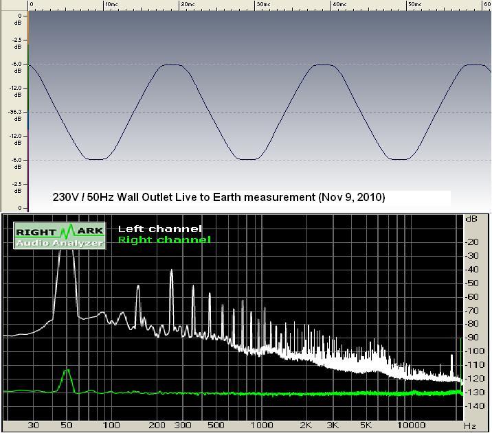

That sort of AC 'clipping' appears to be an artifact of the display. I can get the SAME sort of 'clipping' from one of my early graphic calculators when showing a sine wave. Get real guys!

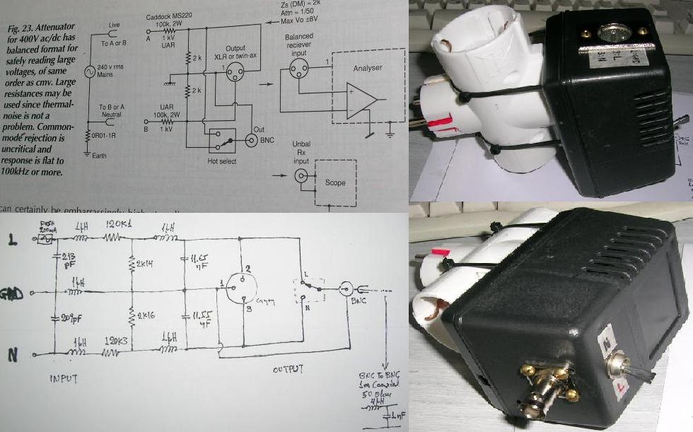

Only usual power mains network distortion. Measured thru 1:2 voltage divider.
This is from a series of utility’s 230V/50Hz measurement at my workshop.
The measurements were done with the “Live Probe” (built after an article in WW), the output of which was connected to M-Audio Audiophile USB sound card.
When the input is 230V, the output of the "Live Probe" has an amplitude of 687mV rms, which corresponds to the –6db in the measurements shown.
George

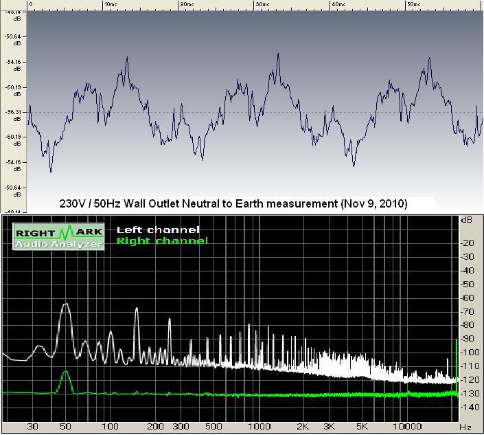

>Edit. The AC “clipping” (Flats at top and bottom peaks) is real. The higher the impedance of the utility’s branch and the lower the impedance of the connected equipment, the worst this clipping becomes.
On the FFT of Live to Earth measurement , the amplitude of the 3rd, 5th 7th and 9th harmonics is an indication of imbalance. So is the amplitude of the fundamental on the FFT of Neutral to Earth measurement.

This is farely common when old lines get added onto until overloaded. But the distortion isnt too bad for a clipped waveform.... 1% and less. But, there are plenty of HF harmonics to get past the internal power supply if not careful in design.

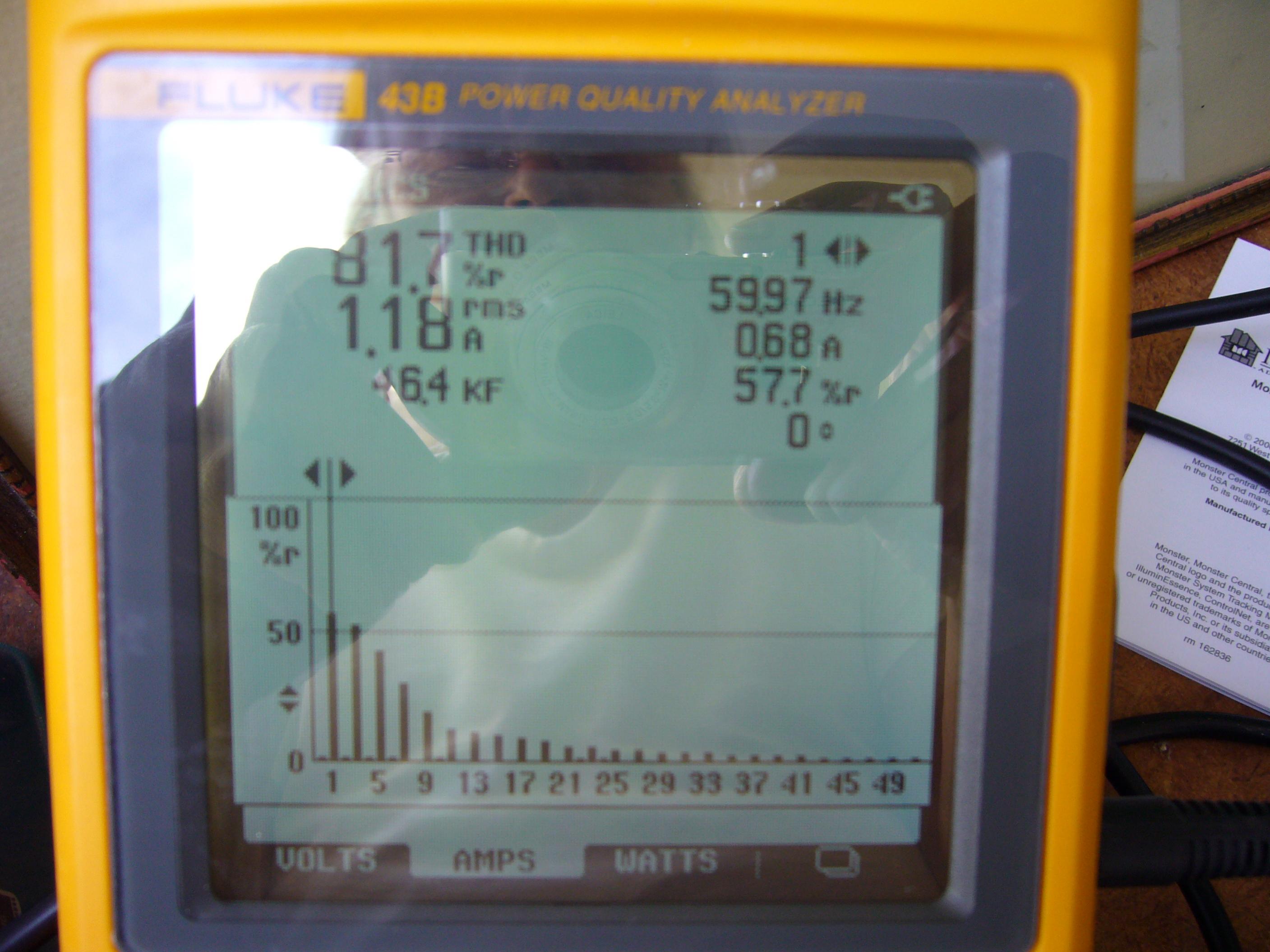

Now take a look at current waveform on the ac line with just a lamp dimmer turned on -- 82% THd and only 1 amp current draw. Even if you have great, clean - non clipped - ac power, you get this with just one consumer product on the ac line within the home. I have shown earlier that the spectrum can go out to many 10's of Mhz. These shown harmonic levels of the ac 60Hz are pretty high.
