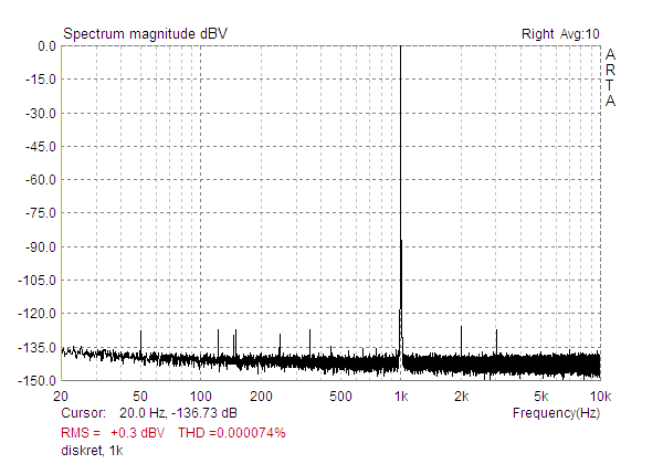

Try to make Your own measurements with EVB for PGA, and after then make conclusions . I used PGA for short period, and I must leave it, because listeners complained "something is wrong", measurements confirm this.. I wrote my experiences to manufacturer with measurements results, no response. Really, something is strange... , But believe , or not, it is Yours decision.
I am not "begginer" , I can make preamp with results as posted in attachment
Which ADC/DAC are you using for these measurements? The residuals are lower than any I have seen.
