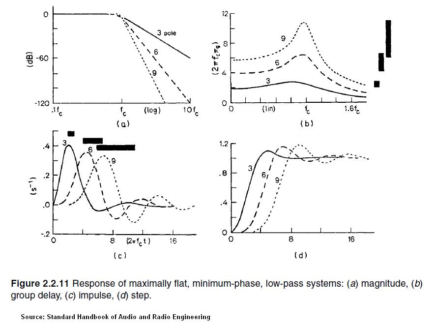

My opinion on GD is that it is one more way of representing phase issues.
As it is (mathematically) the negative of the rate of change of phase
with frequency, it follows that when there is a steep change in phase within a frequency band, one should expect an increased group delay in that band.
For electronic gear testing, I don’t think it is of much help. It is a great visualization help when testing electromechanical transducers.

For loudspeakers anyway, I have not found GD to be particularly useful as a tool.
The problem is that GD IS useful for narrow bandwidths, the problem for wide band anything is that for a given operation, filter or whatever, normal operation of it takes say 1000 times longer at 20Hz than at 20Khz.
This leads people to be horrified by a subwoofer with large GD caused by a low corner Frequency, when that same GD is what should be happening.
On the other hand, as the late Dick Heyser correctly identified, one can imagine a full range loudspeaker as having a frequency dependant front to back position which is indicated by the loudspeakers acoustic phase.
The acoustic phase and amplitude response both governing how the loudspeaker reproduces an input wave shape and how it rearranges the harmonics in the signal in time when they radiate.. Only when a loudspeaker can unilaterally (anywhere in front) reproduce the input wave shape is it retaining the signals harmonic structures in time in that frequency range .
The acoustic phase here as Dick saw it is the measured phase with the rotation cause by ALL of the fixed time delays removed. For his system (the first to do this) TDS, one first measured the time delay with an “ETC” measurement.

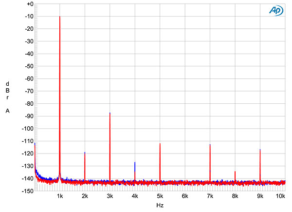

From Stereophile (ClasséCP-800 D:A preamplifier):
The volume control is implemented with two two-channel Burr-Brown PGA2310 programmable-gain chips, one per channel used as a differential volume control.
Tonally, the CP-800 fell into the camp of the clean and clear rather than the mellow and euphonically colored. In that respect it was somewhat similar to the Parasound Halo JC 2 ($4000), which I reviewed in March 2008: A wealth of recorded detail was laid bare without being spotlit. In level-matched comparisons with the Ayre Acoustics K-5xeMP ($3500; I reviewed it in June 2011), the Ayre sounded slightly veiled, though there was a robustness to its soundstaging that resulted in more fully fleshed-out images within that soundstage.

About measured distortions of the Classé:
"Although the level of distortion with a full-scale digital input signal was low in absolute terms, it was higher than I expected, the third harmonic lying at –77dB, or 0.014% (fig.6). Reducing the output level by 10dB with the volume control preserved the level of the third and other harmonics (fig.7), whereas reducing the level of the signal data by the same 10dB dropped the third harmonic to –87dB, or 0.005% (fig.8). This suggests that the slight nonlinearity occurs in the D/A conversion circuitry ahead of the volume control.,"
Note that they made measurements at various volume control positions, and the distortion DECREASE with attenuation and levels (as expected and opposite to your remarks).
[edit] Not so sure about their analysis, may-be the switches are the responsible, but at least HD ratio does not increase.
