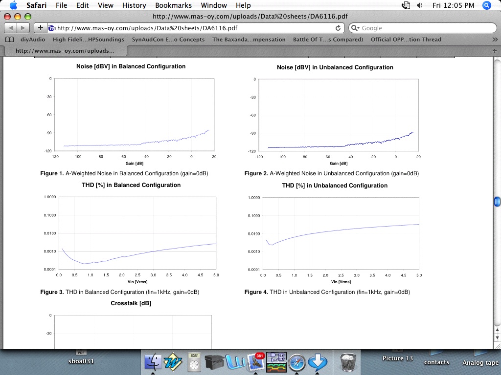

Looks like a pretty nice part. Nominal impedance 10k, and you use external amplifiers. They state that the zero crossing mechanism eliminates clicks, which isn't strictly correct, but so it goes.
Everyone, please look at figs 3 and 4 on the specsheet put forth by Esperado. What I see is a distortion measurement with input level at FULL OUTPUT. Am I wrong in assuming this?
Yes, you are. Full gain is +15.5dB.

Look at posted 3 pictures..MDAC, PGA and realy atenutor. Maybe here is some language barrier, but for sure I am not confused with 0dB (gain) and 0dBV (absolute level). Again, THD figures for PGA are for gain diferent (lower than) from 0dB worse, than for 0dB. This not valid for MDAC, nor relay atenuator. Try it , I tried personaly in last ten years MDAC ( a bit complicated "driving" for dB steps), WM8816, PGA2310, MAS6116 (all very covenient for use), and finally I stick with relay attenutor. It is simply sonically the best solution with best measured parameters.No measurement comparison of relay vs MDAC, no details on listening tests. And he's confused 0dB (no attenuation) with 0dBV in Atkinson's measurements
No , picture 3,4 :"THD bal/unbal, gain=0dB"..Yes, you are. Full gain is +15.5dB.
