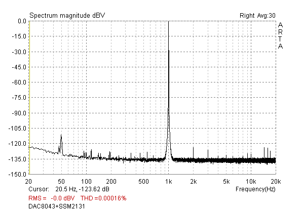

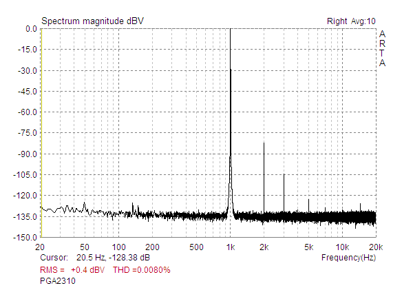

Best from those was CMOS DAC (DAC8043) with good OA, e.g .LM4262. Catalogue data are quite nice, but try to measure e.g. PGA2310 at -6-20dB gain (not 0dB..) and input signal about 2V RMS.

Perhaps you could point out where the measurements show the use of a multiplying DAC?
Look attached pictures, DAC+OA measurement is about 3 years old, loopback ,unbalanced connection (so visible 50Hz), PGA in balanced connection. Same level, same measurement conditions.
Can show the circuits you used. A lot of this has to do with implementation.
That is NOT the PGA23xx I know and love! 2H -75 dB down? You should be sitting between -100 and 110 dB into a 2k load.
