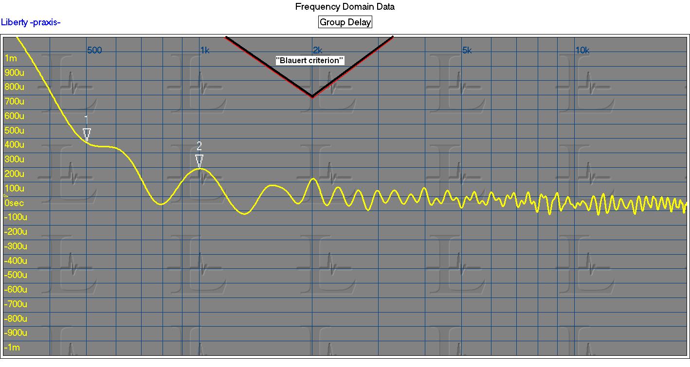

Gpapag, what do you think of this enclosure's group delay:
http://www.moonaudio.fr/Photos%20taille%20affichage/group%20delay.jpg
Christophe
I can only say that it surpasses the “Blauert criterion” for an on axis measurement. 🙂 (and that I would be proud if I could achieve such a measurement on a speaker of mine!)
Alas, in my opinion this criterion runs the risk of becoming a new “THD figure” case (for the speaker industry).
My understanding after careful reading Blauert-Laws paper is that there are more than one reason that this criterion –as stems out from that paper- is immature for to be adopted as a well tested GD figure of merit.
The complexity of the subject, the startling differences between theoretical predictions and actual measurements, as well as the painful result discrepancies from using artificial signals and musical signals for evaluating x-overs/speakers, are summarized in this exemplary work, which sites and discusses almost everything that has been tried so far
