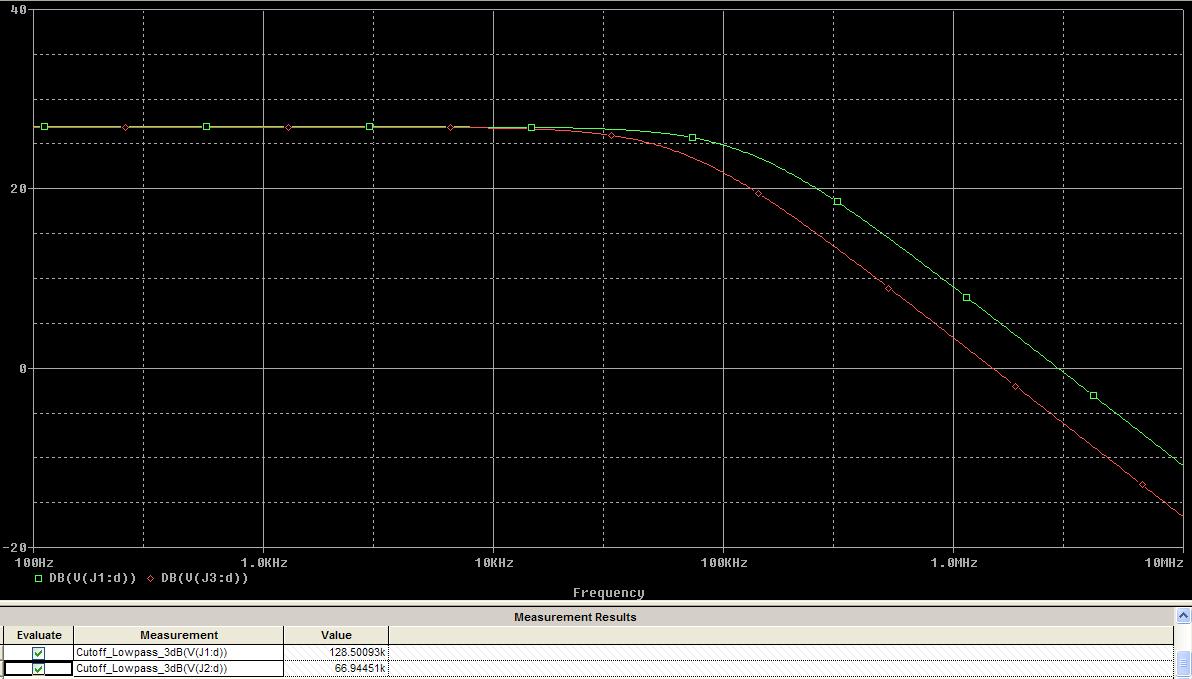

Well, that brings up my (somewhat naive) question- John says that paralleling two lower Idss devices doubles the input capacitance. I can see that it's double the input capacitance of one lower-Idss device, but in circuit, will the input capacitance be double that of a single device with twice the Idss?
Paralelling multiple devices for the same Idss won't lead to a significantly higher Ciss compared to a single device. Otherwise said, Ciss depends significantly on Idss (higher with higher Idss).
However, Crs depends weakly on Idss. By paralleling devices, Crs will increase. As Crs strongly depends on Vds, it is to be expected that paralleled devices will have a poorer frequency response and a poorer linearity.
Thanks, this is what I thought. Now as to the second part, how significant is it? I.e., for the devices we're talking about here, what's the difference in frequency response and distortion (as an estimate, assuming a 25k source impedance from a worst-case 100k pot) from paralleling two lower Idss parts compared to a single higher Idss part?

See attached. As expected (as long as Crss doubles), the 3dB cutoff is about half (from 128KHz down to 67KHz).
Also as expected, distortions are increasing with about the square root of the Crss ratio (here, 2), from 1.5% to 2%. This is for 100mV input and gain as in the attached picture. Idss is about 20mA.
Edit: Of course, green is single JFET, red is two paralleled JFETs, for about the same Idss. Bottom line, John is right but for all the wrong reason. It is the Crss that degrades the parallel JFET configuration, not the (input) Ciss.

Many thanks! How does that scale for a 1mV input, more characteristic of a phono stage. where (as Scott points out) the noise motivates paralleling if selection is impractical?

For a phono stage, it doesn't make sense to consider a 25K source impedance. For a realistic 50ohm @ 20KHz MC impedance, the distortion gap widens to about 3:1, but numbers are already low (0.01% to 0.03%). Bottom line, for MC preamps, paralleling JFETs has practically no impact on distortions and bandwidth (because of the low source impedance).
EDIT: for MM, the situation is significantly different, both because of larger input signal (2.5...5mV) and large equivalent source impedance @ 20KHz.
