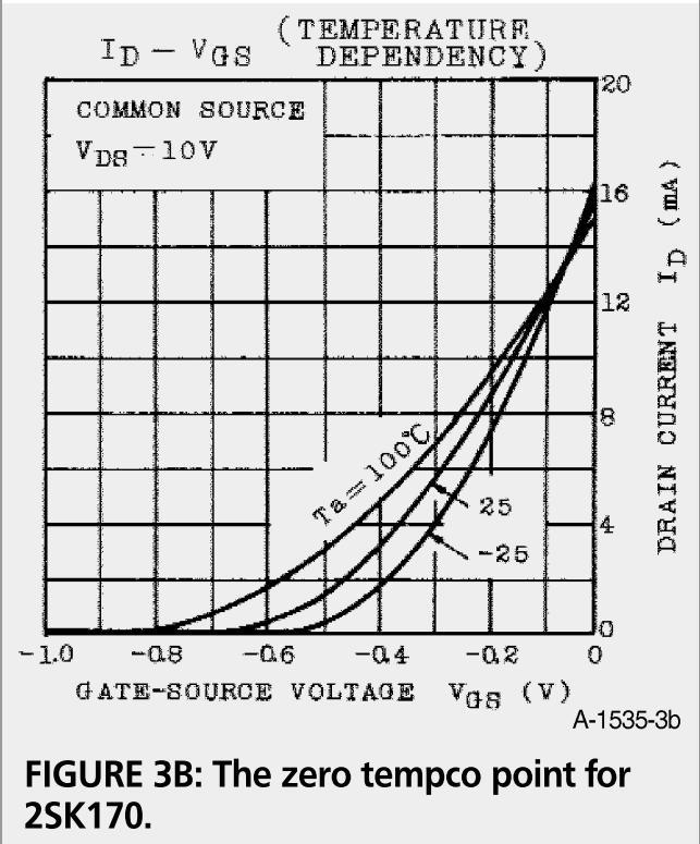

My suggestion - let's discuss idle current of the input JFEts.
Zero tempco point or as close to as possible.
Zero tempco Vgs = Vp+0.63V where Vp is the "pinch off" voltage (g-s)
For the Toshiba high gm types it is very close to Idss.
There is another zero TC point which is useful. Where any Idss FET from the distribution will have "zero" TC of drain current when used as a current source via a source resistor. This is typically at a low current (below the Idss for any of the FET's).
Yes. And you work in a most linear portion of the transfer characteristics and get lowest noise as well. Interestingly enough, most even well known designers run the JFETs at low idle in audio preamps. Like 2mA for a 10mA Idss device. Any good reason to make it so? I can guess the only one - part selection not needed then.
