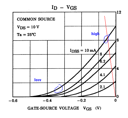

Yes. And you work in a most linear portion of the transfer characteristics and get lowest noise as well. Interestingly enough, most even well known designers run the JFETs at low idle in audio preamps. Like 2mA for a 10mA Idss device. Any good reason to make it so? I can guess the only one - part selection not needed then.
The gm is the same at 2ma (plus or minus a little) and noise is actually a fairly weak function of drain current (gm -> square root, noise -> fourth root). I can certainly see designs where input gm figures into the BW and stability issues. Not all circuits are open-loop.
But linearity of transfer characteristics is much better near to Idss. And even for FB designs there are no stability issues - depends on overall design. If you compare high and low idle, you get both lower distortion and better sound 🙂))at high idle.

You might just as well select for Cin and assume that IDss does not change.
For me, it appears quite shortsighted to think that one gets the same input capacitance
for average and extreme IDss&gm devices made on the same process.
I'd bet there is a correlation. I'll check this next week with BF862 if I have left enough of them.
Gerhard
Well, that brings up my (somewhat naive) question- John says that paralleling two lower Idss devices doubles the input capacitance. I can see that it's double the input capacitance of one lower-Idss device, but in circuit, will the input capacitance be double that of a single device with twice the Idss?
