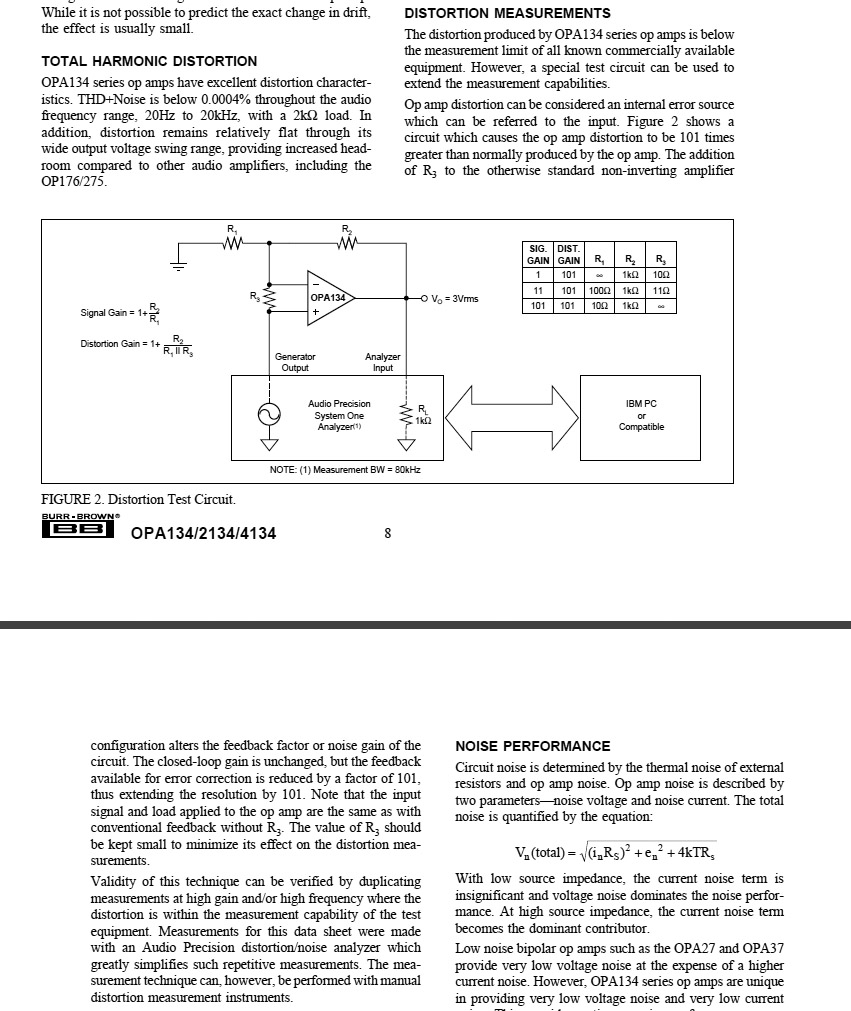

About the setup to increase distortion a good basic explanation is given in the opa134 specsheet http://www.ti.com/lit/ds/symlink/opa134.pdf
This is the relevant part and I hope it reads well. It is easy to see that the input impedance is defined by the input impedance of the opamp. If R1 is included. It is a voltage divider consisting of R1 and R2, which keep the voltage at the inverting input at the voltage at the non-inverting input, which is Vo of the generator. No current flows through R3, except most part of the error voltage. In case R1 is omitted, so for G=1, the situation is identical, since Vo of the op amp is now identical to the Vo of the generator, bar again most of the error voltage.
I think Scotts explanation using the concept of bootstrapping is a bit misleading. Nothing is really bootstrapped as I see it, except for the error part, it is like reverse degeneration. The input impedance seen by the generator is exactly the input impedance of the opamp, plus whatever error voltage has to be sunk. But that is minute.
Nice little experiment for a Sunday afternoon: by replacing R3 with a small pot, one can have a continuously variable distortion component at an opamp output. I did this when I started working with OPA134, just to hear when stuff becomes audible and because I like the smell of rosin core in the morning.

If you have an input resitor and drive the other end with a replica of the input voltage so the resistance appears much larger to the driving signal I call it bootstrapping as it is in general use.
Well, my point is that you don't see a replica of the input voltage to lower the resistance to the driver signal, so there is no bootstrapping there.
Let me refer back to you post #32541
The signal gain is one and since the 10 Ohm resistor is bootstrapped by the Aol of the op-amp (divided by the feedback factor), the input resistance is very large, any bench generator has no trouble driving this +-10V. ALL errors refered to the op-amp input noise, CMRR, distortion, etc. have a gain of 101 to the output. Do you really not see that? Simply consider a nearly ideal op-amp put 10V on the + input the op-amp forces the - input and the output to 10V by feedback i.e. there is no current in either resistor, the circuit acts like a gain of 1 follower, and the input resistance is very large. If need be say the op-amp has an Aol of 10^6 so 10uV appears across the 10 Ohm this is all the generator needs to supply i.e. the input looks like 1Meg Ohm.
Since I am following the threat on a discrete opamp with interest, and have learned a lot of your insights there, it is with great trepidation that I go against your statement here.
1. Both + and - inputs of the opamp will be at the same potential, regardless of the Aol of the opamp.
2. Therefore, the 10 Ohm resistance will carry no current, this with a perfect opamp.
3. With an imperfect opamp, only the error signal will develop over the 10 Ohm resistor.
4. This error signal is all the signal generator will see, this plus the input impedance of the opamp.

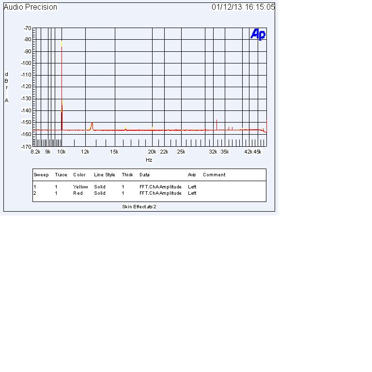

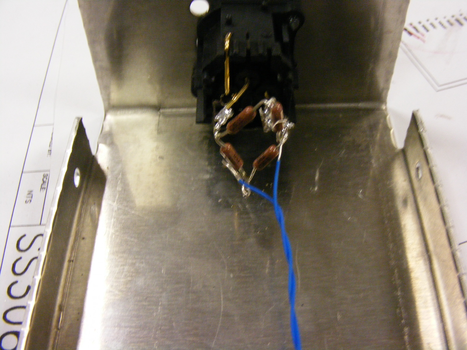

You are a grrfter nerzzog frakidle! Attached is a picture of the test setup and the FFT with the wires close a shown and then pulled back. The third harmonic is identical and extremely low. That would be from resistor distortion not quite being the same. There is a clear spike on the second harmonic with the wires close. It is greater than the thermal distortion.
As this took me 4 hours I am not inclined to do much more.
But the peanut gallery as usual is arrogant and wrong.
ES

To recap for the peanut gallery, this exchange started out by George and I discussing resistor distortion, when I mentioned that opamps today can be limited by the passive parts and cited the LM4562. I then mentioned I thought that it was mismeasured it went off on a tangent.
My feel is that they got an AP and used it to produce lots of wonderful pictures but did not quite have a grip on it's limits. It seems that when you measure THD it looks at the frequencies above the fundamental. As a result for the same level of distortion as the frequency rises the displayed result drops. The second issue is the base noise level of the AP when in the THD mode. When a human looks at THD today they should be using an FFT with adequate resolution and often averaging to reduce noise. They can then pick out distortion from noise. Using autopilot may not do that and be misleading. The final issue exactly which circuit did they use at first to make measurements. Scott points out that AD does it correctly and presumes other do also. (Which I think is our only area of disagreement.)

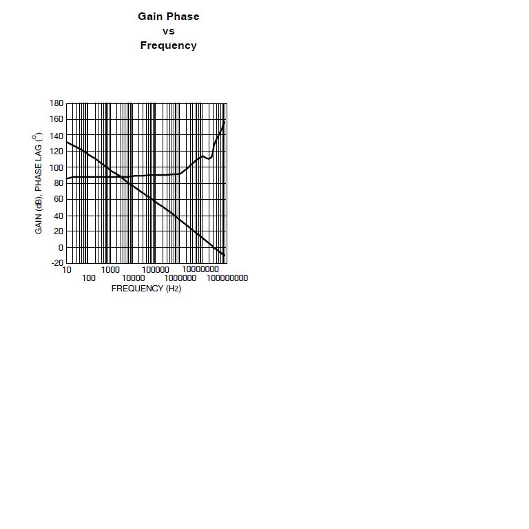

However in the LM4562 data sheet I found a wonderful curve, Phase vs Gain. If accurate this device would do wonders for some types of signal processing. But I think they really meant phase margin.
