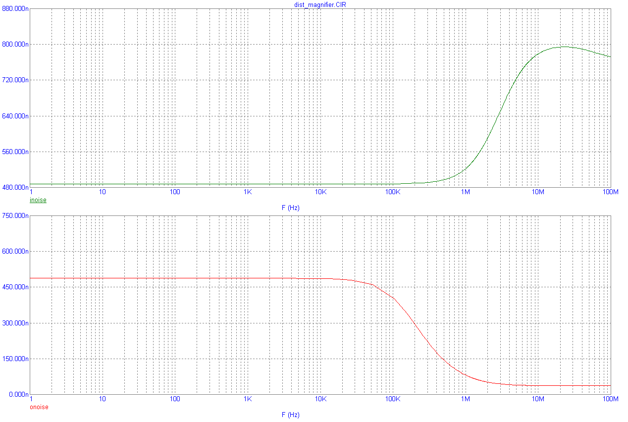

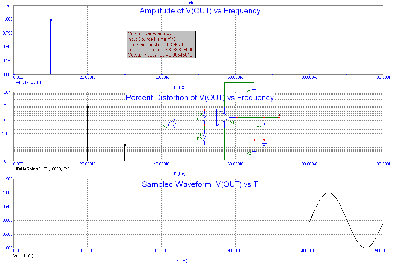

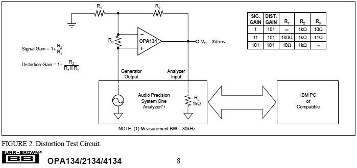

Distortion Gain (Noise Gain) equation in vacuphile attachment may be a good opportunity

Yes, the values attached in the picture here:
http://www.diyaudio.com/forums/anal...ch-preamplifier-part-ii-3259.html#post3323513
applied to DC gain and DC impedances. (for OPA627)

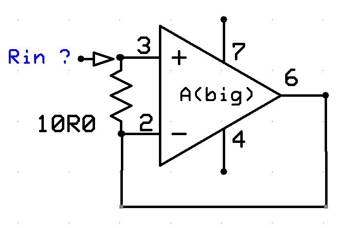

Sorry PMA missed that, I was going then to say what changes when you add the 1k, you get 100 more of the input error signal for 101 times it at the output (within a tiny amount). I wanted to show it without having to do equations for the absolutely exact answer to more digits than matters.
The problem is CMRR error is also amplified, presumably heavily loaded gain is clearly worse (not necessarily)? At gain of one you see the common mode error anyway but not as a gain of 101 follower.
Sorry for getting impatient, but presented this simply I think this is pretty basic stuff.
