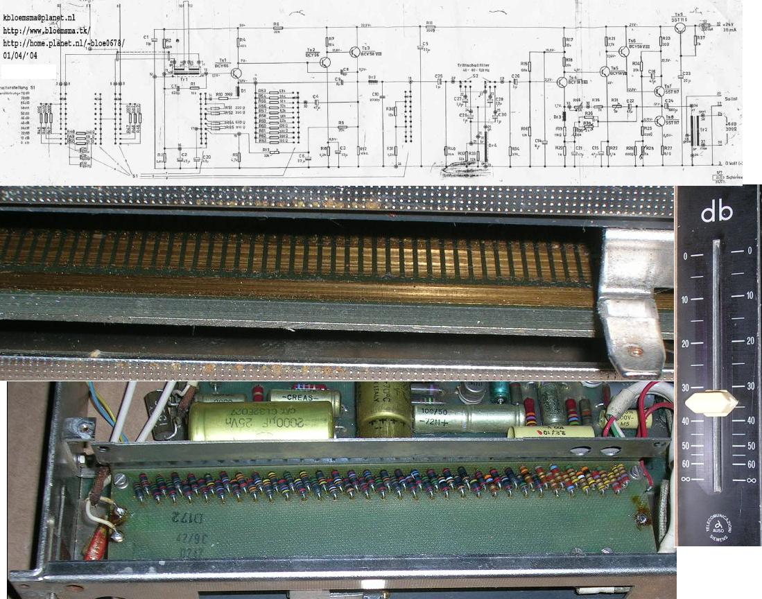

Behind the slider, with older console modules, attenuators were not simple potentiometers.
George
They where the worse: you can hear little clics or step changes if you moved the sliders, during mix-down, witch is a requisite.
A lot of more recent analog mixing desks used Penny & Gilles sliders, motorized or not, just to control a DC: the sound level was processed then by awful VCAs, full of distortion.

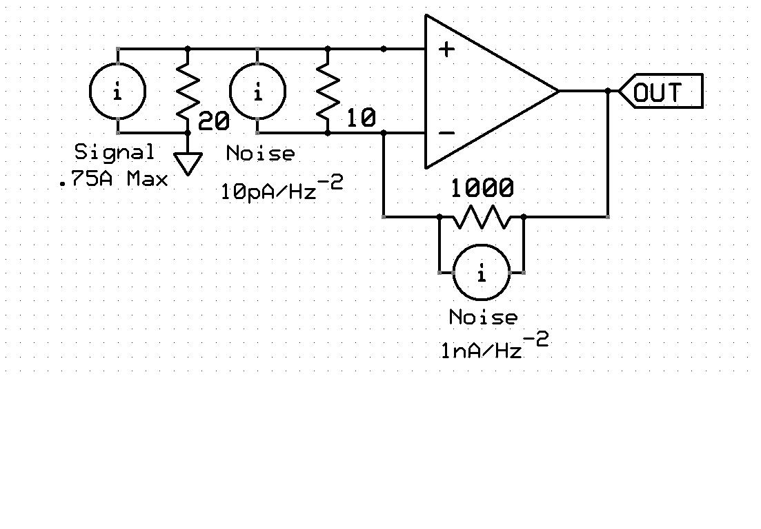

I have had a chance to think about the last set of measurements and the difficulties I had getting nice clean plots. So here are my ideas of the proper way to do this test.
I have on hand 100 of the Dale CMF55s at 10K and 1000 of the Yaego 10K both rated at 1/4W. I will get out my GR Digibridge and match 4 of each. I will punch an aluminum box to hold plastic shell XLRs at at each end. The diamond of resistors will be held in place at the output end by the connecting leads which will be a twisted pair or 18 gauge or so magnet wire. The input side will be 26 gauge or so magnet wire also twisted. I will do measurements at 100, 316, 1000, 3160, 10,000 Hz. One set will be with the input wires perpendicular to the resistor diamond for minimum coupling. The second set will have the input wires dressed close to the top pair and the third test will be with the wires dressed to diagonal resistors.
Scott,
Don't pull the rope! It is not a snake or a tree or even a wall. Don't pull the rope. As usual I think we both have quite different perspectives on the National IC test results. When I presented what I thought was a simple circuit to write the equation virtually no one could do it. So below is attached the schematic of how I perceive their test setup. You are welcome to try the circuit equations or to model it. I suspect my back of envelope calculations are certainly within an order of magnitude or much closer than the factor of 100 you feel is right. (I can do the equations for a "Noise Amplifier" circuit as shown. The basic issues are not what is the noise gain (I think we agree it is 100) but what is the signal gain and input impedance. I have set the input source to model the AP System 2. I think this will help clear the air about the differences we get, (I think we are starting with different assumptions.)
