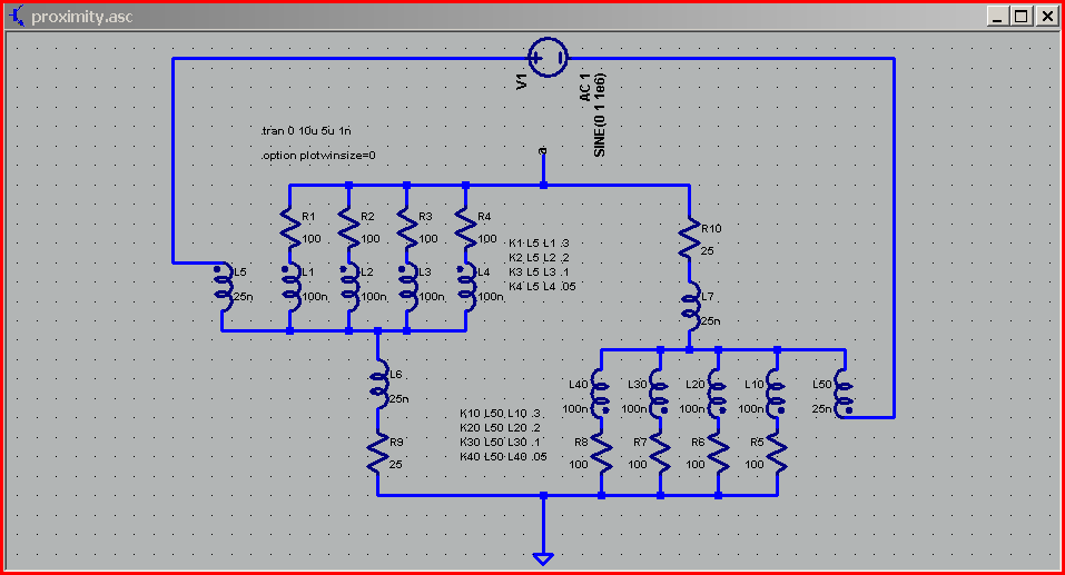

my very simplified model of a lumped "proximity effect" simulation
inductance, mutual inductance K values pulled out of thin air - just illustrating the principle
the diff V is going to linear to limits of the materials electrical parmeters linearity - for the spice models, the fft is limited by numerical resoution at about -180 dB with default LTspice fft settings

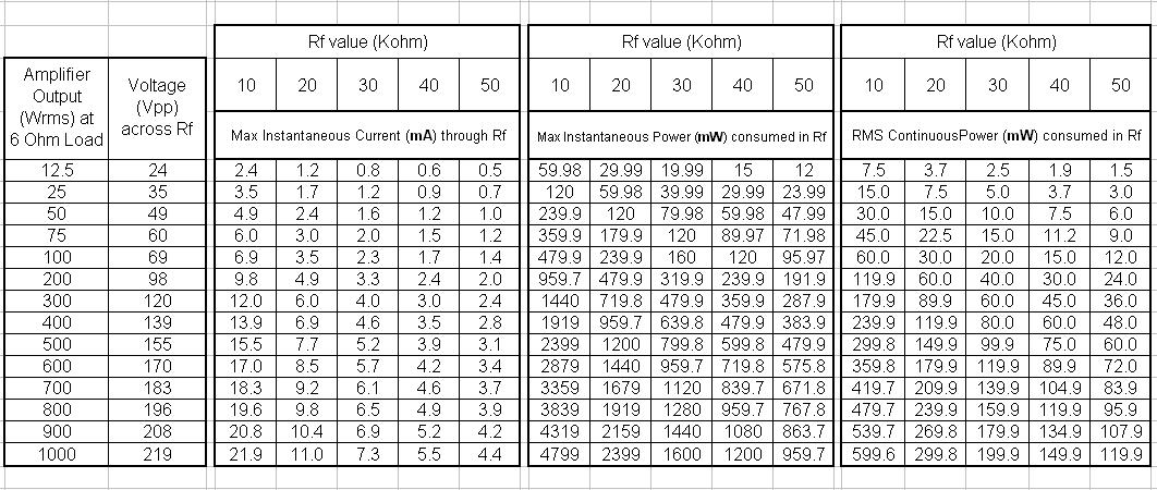

100 W 6 ohms (?) P=E^2/R = Vrms=24.5 Vp-p = 69.29 at 10K =.48W Peak but really .06W. At 8 ohms Vrms=28.28 P=.08W

I attach the corrected table.
So with a KOA/Speer 1/4W 10K Carbon film resistor I would expect .00052% distortion @100 Hz. from the feedback resistor. The LM4562 lists it's distortion as .0003% so the resistor is not as good as the "Horrible" opamp.

distortion is listed as 0.00003% -0.00009% (5th decimal place) at 4V out, 600-10KOhm load and the measurement is conducted with a 1K Rf (see Fig.4 for the trick used to measure such low distortion), thus this figure should logically include the distortion produced due to Rf.
Apart from this, how do you perform the resistor distortion calculations?

Thank you Ed.
The 1.414 multiplier on second column fell into the glass of Ouzo and lost it’s senses.
Nice model. However, there is no good way to simulate a field modified resistance. You can include inductive coupling, but not the variation of resistance with slew rate. And, see above, you need some ideal rectifiers in there.
