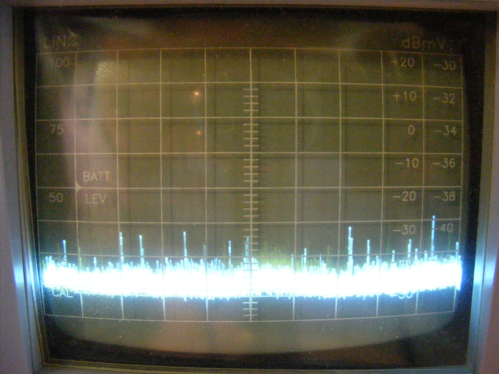

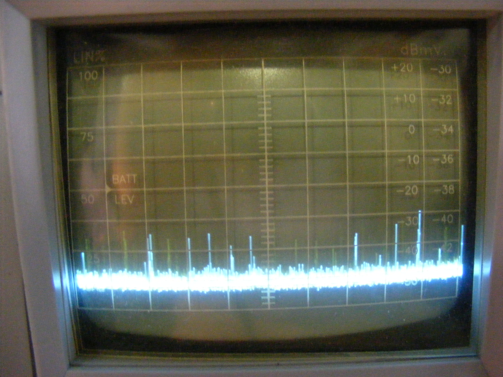

Can-you explain the advantage of a 50/60Hz modulated noise (by the diodes conductance) VS the same noise, but constant
Figure 1 is without the diodes, Figure 2 is with. There is 10 db less noise from the 120 Hz modulation and 30% duty cycle.
As there are inductances and capacitances in real circuits there is less overall and momentary noise.
