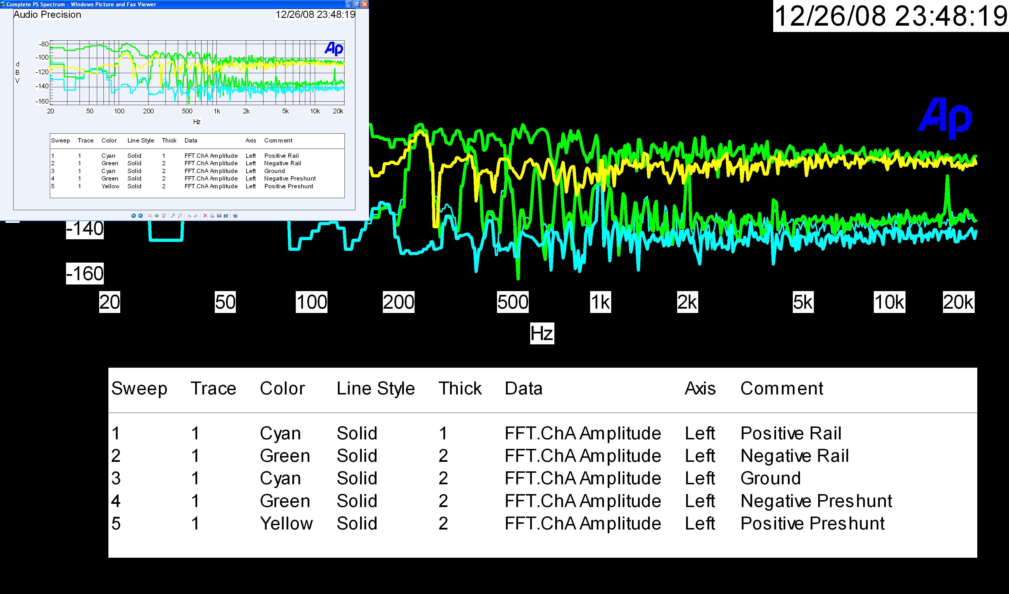

The noise floor of a battery can be calculated from the internal resistance which rises with age and use. (Of course you knew that.) In an AC powered supply you usually use regulators that are feedback based and can lower the effective resistance of the power supply. Of course you can also regulate a battery supply. I do use 12V 4AH lead acid batteries that are followed by active filtering circuitry in my most sensitive measuring gizmos.
Attached is the FFT of the power supply rails in a preamp before and after a pair of shunt regulators. There also is a trace of the input shorted. (It processed a bit strange but you can still read it so I am too lazy to redo it!)

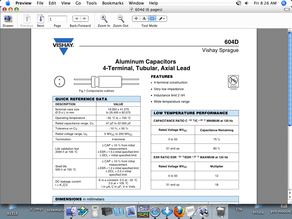

The Kelvin connection caps take that one step further and essentially eliminate cross-coupling of noise/ripple and interstage coupling through the power supply. I've tried the Suppression Devices polyprops and they work as advertised. Reasonably priced, as well. SD do an excellent job of getting tight windings and low ESR/ESL. No datasheet, but Valve Amplifiers 4th edition has detailed analysis and measurements showing the advantages.
Link to the datasheet for the electrolytics that John mentions:
http://www.vishay.com/docs/42040/604d.pdf
