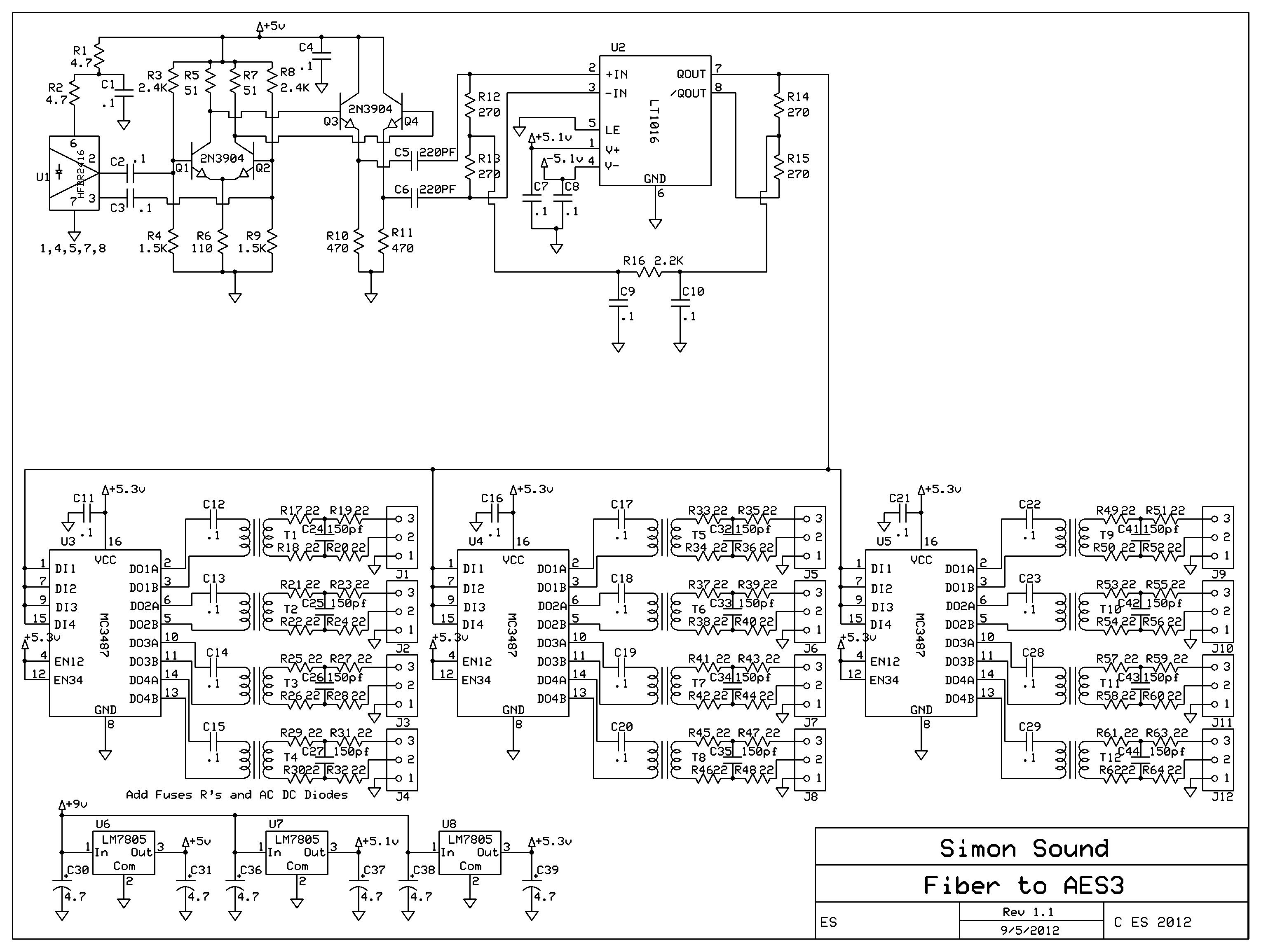

Thanks for the useful input here is the revised version.
Pavel will find the integrator interesting as it uses a prone to overload chip. The data sheet shows some interesting quirks.
ES
It looks like you are trying to lock a VCO to an external oscillator (it says rubidium). For the input conditioning from the external source there are a number of good solutions, start here: Oscillator Waveform Conversion. The manual for the Lpro here http://www.ko4bb.com/Manuals/05)_GPS_Timing/Datum/LPRO/Datum_LPRO-101.pdf starting at page 16 has specifics on interfacing for lowest phase noise. The Wenzel site has good info on type 2 PLL's for this.
However I would question where getting the frequency of the master clock slightly better will be ever detectable, let alone by ear. I would use a GPSDO as a source instead of a Rubidium, no wear out mechanisms. But a good crystal oscillator would be far more imporatant.

OK you've convinced me to add the two bias resistors. However note the actual output is direct coupled and runs at 3.3 volts
The rubidium standard is the Stanford PERF10 Rubidium Frequency Standard - PERF10 which can lock to a GPS source for long term stability. The rated life of the lamp is greater than the design life of the system.
The VCXO details are not given on the schematic. It uses peltier devices to cool it. There are a few tricks in mounting it to reduce vibration transmission. Jitter is in the reasonable picoseconds range.
Using this quality of reference adds 0.12% to the cost of the entire system. The master clock syncs over 200 slaves.
As to the nice references, I can't disagree with the techniques shown, as I am using them to recover the signals from the fiber with them. Jitter is below what my AP can measure.
Schematic attached.
Now the issue is what will it take to measure the jitter?

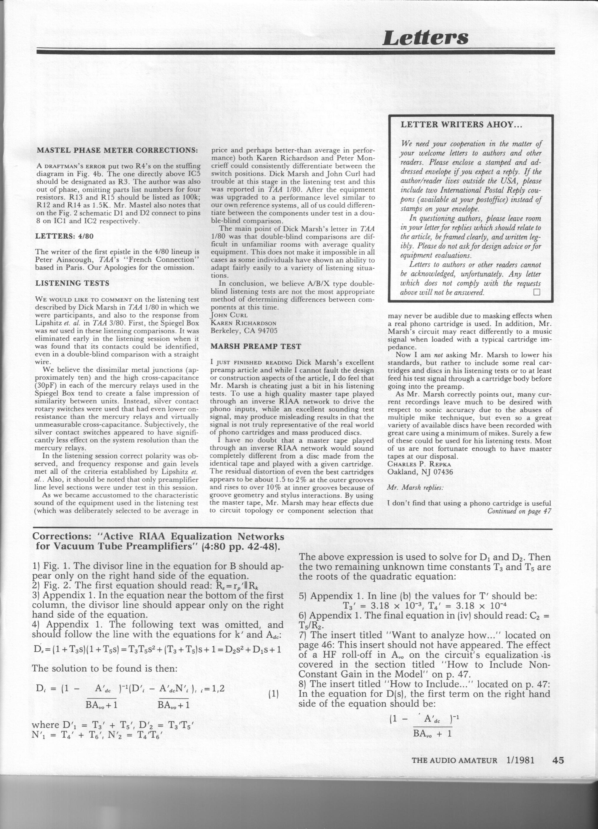

I'm surprised the mercury units did poorly, but your letter to the editor indicates that perhaps the problem was that the overall design of the relays was poor, and the benefit of the wetting was insufficient to counter those deficiencies.Well, I guess I can start.
The worst contacts that I ever came across were sealed mercury relays in an ABX box. The best contacts I have used are Shalco silver rotary switches that we used in the CTC Blowtorch.
So, a very good electromechanical switch which then added mercury wetting to its features could be an excellent unit ... would that be fair comment?
I should also mention that I like silver, in the various contact enhancement forms. Many people seem to have had bad experiences with the stuff, but I suspect sloppiness in using it is the cause of that. Like everything in the audio game, technique is a major part of the battle ...

Fas42, I appreciate your input. I did define a specific mercury relay as problematic, but I can't be sure of every type of mercury relay. However, think about the materials necessary that will not dissolve in the mercury. A highly marginal lot of material. I would not make a wire from it.

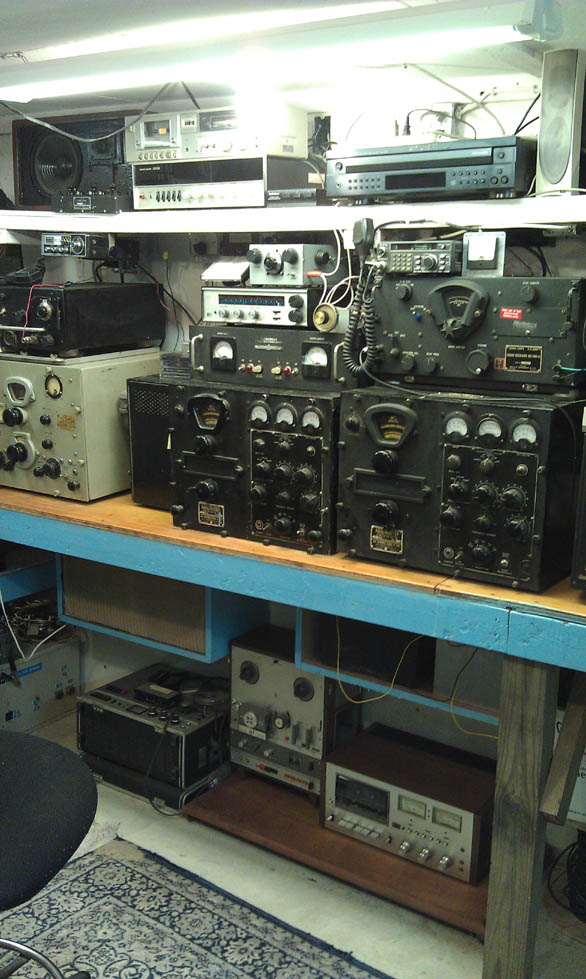

Deep in a swamp in eastern Massachusetts there is a secret labyrinthine man-cave that hosts an annual Christmas party for the local design community. This ritual has gone on for over 30yr. This is where we celebrated SY and jneutron’s birthday (in abstentia) as well as Christmas.
1 – They all work (of course) 2 - spare parts 3 – An appropriate wine

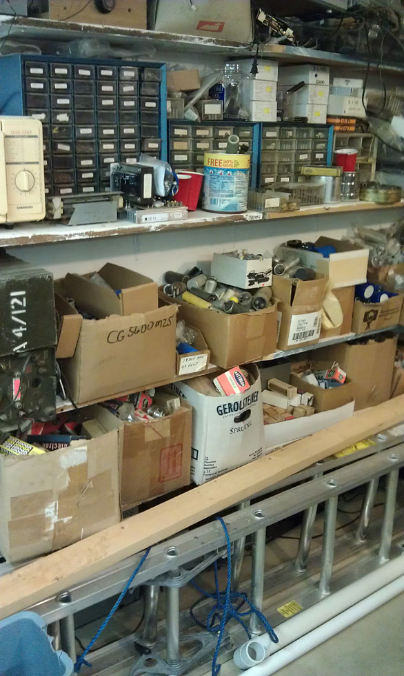

I'm pleased to see examples of aging of cardboard containers, in neat rows, as a way of improving the contents. At least the audio community learnt one thing from the wine industry ...2 - spare parts

Scott,
Some of that equipment looks like it is vintage my birthday in the 50's. You say it all works... Does that mean that the owner, if not you, needs to turn that equipment on, on a regular basis to keep the electrolytic caps happy? If yes how often would that need to be? Real questions here......
