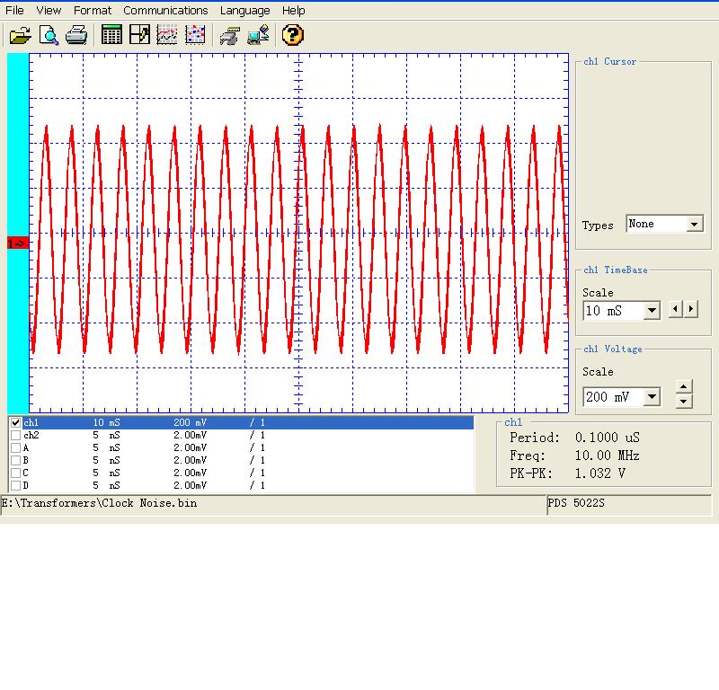

I have attached a shot of the sweep noise from an eBay $60 rubidium oscillator.
The roadies today use an Apogee Big Ben word clock on their consoles because they notice an improvement.
So we are in agreement that a high quality crystal oscillator is adequate. As the screen shot shows the 200hz sweep noise from a rubidium source may be a problem if not used with a crystal oscillator.
Where we differ is that my system is not just playback. I also have A/Ds and record. Accurate time stamps are very useful in recording. So the full works with GPSDO is useful. I expect the video guys will take a clock from my system.
Now as to crystal temperature. You are right in that crystals have long been designed to work in an oven, so they cut them to work best at an elevated temperature. However if you look at the curves you will see they flatten out at lower temperatures. One issue is how accurately you can control temperature. So my playing around has shown lower jitter at freezing. Due to the properties of the frost formation the temperature is quite uniform and stable. (Moisture in the air is the actual regulation mechanism!)
At freezing the issue then comes from changes in moisture level on the outside of everything that is not hermetically sealed.
