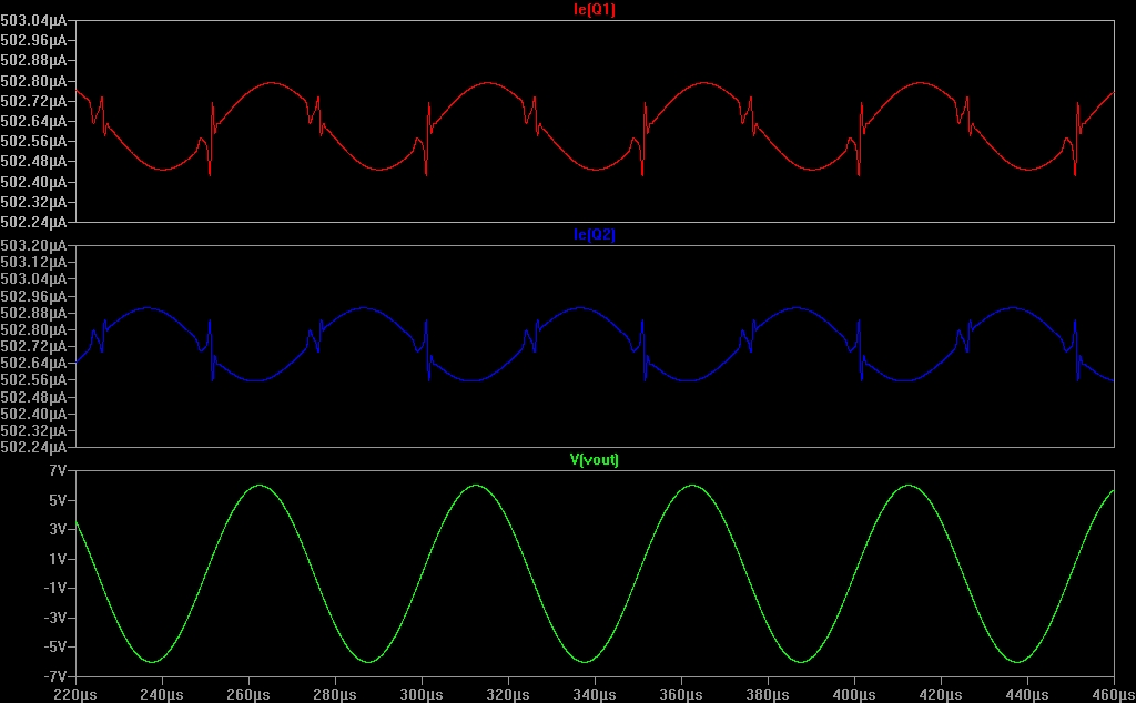

Sorry, Bob! Another take on what happens in that TPC circuit, in this case dropping the input drive to create a output waveform well within possible real world music replay -- output waveform looks very clean, but look at what those emitter (and wrongly called collector in other post) currents are doing in the crossover region ...

Any square waves at high frequency to show ?but look at what those emitter (and wrongly called collector in other post) currents are doing in the crossover region ...

Thank you Frank for the instructive post. (*) The slope and the kinks of the waveform is a direct indication of what is going on higher up in frequency, beyond the reach of indicating instruments that us humble diyers can have in these non promising days.
Supply current of each stage, if carefully monitored and plotted against varying input signal’s amplitude and frequency –no signal included-can too provide indication of HF oscillation.
The locus . (Nyquist plot) of Aβ of an amplifier if driven high in freq is the ultimate “tool” for inspecting instability.
Having (or building) a signal source that can go to VHF is more important and within the “budget” of an amateur than buying a 500MHz scope.
