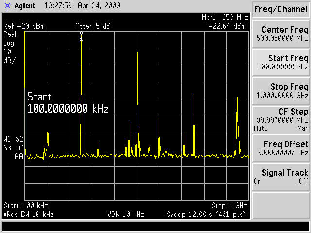

I just had hoped that one or some you professionally trained guys could explain to me how a circuit tending towards resonance at 15Mhz for example ends up making an amp sound rough in the audio band - that's something I experienced but never really understood. If no one understands it that's fine I'll stop thinking about it.

I'm just saying that you have not posed a problem in enough detail so there is someting to discuss, fairly anecdotal observations are not enough.
As a counter example I once built a Borbley FET follower a forgot to bypass it, it oscillated at 60MHz but still sounded fine. Even John has stated that simple circuits (especially those using high capacitance JFET's) often need better power supplies.
I see no arguments against circuit complexity, after all is a cascode complexity? A Siklai pair (quite popular here ) is well known to have stability concerns, a simple emitter follower can oscillate with a nasty load (speaker?), the list goes on.
Scott, I hope you would not mind if I post a measurement of 250MHz oscillations in a BJT preamp ...
