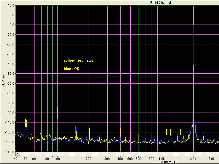

Oh yes, I did. It was absolutely perfect! I was unable to find anything with a 100MHz analog scope ...
The only indication was increase of mains components in FFT ... pls see attachment.

Yes. Thanks for mentioning the low frequency accompaniment to the VHF parasitic. There is often as well a significant increase in inband noise, a sort of downconversion.

You may sleep well 😉. The 1st indication was purely sonic, by listening. When oscillating, a low-level buzz from speakers was audible and there was a loss of 'space' information. Then I started to measure and finished with Agilent UHF analyzer measurement, that revealed the problem entirely.

Thank you. In this case, THD remained unaffected and in-band noise had not increase, but I have another examples where an in-band noise had increased, or THD had risen.

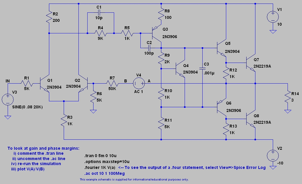

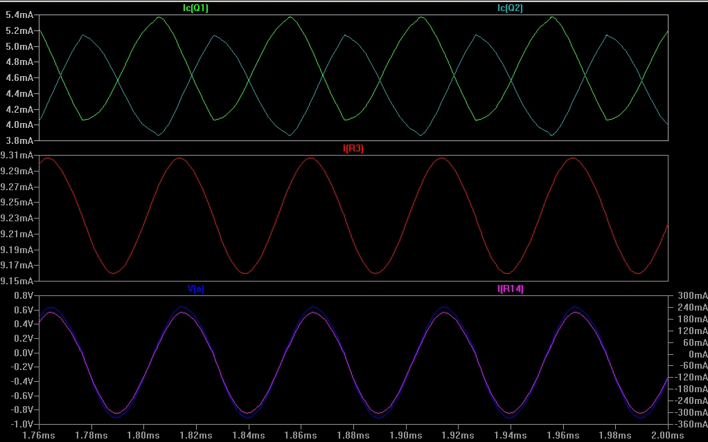

Okay, had a simplistic play with the "educational" audio amp circuit that comes with an installation of LTspice to see what happens when the FB circuit is stressed: this was done by dropping the load resistor from 8 to 3 ohms, and feeding it a 20k sine at an input level such that the output stage is still well below clipping. Of course, this is a very basic circuit but it does work as an amplifier comparable to a lot of stuff out there. The output waveforms are not brilliant but look reasonable enough.You won't hear the oscillations, but if the circuit is misbehaving in that fashion then the chances are that it can't be functioning as intended in the audio region; again, especially as far as the FB mechanism is concerned. It seems as if I'll have to play with LTspice, deliberately simulating non-linear behaviour in the output, to see what signal frequencies the FB area of the circuit is experiencing ...
Frank
But, note the the current waveforms of the collectors of the differential input pair, Ic(Q1) and Ic(Q2), the FB having to cope with correcting crossover distortion; these are starting to look very nasty, meaning high frequency components, well above audio, are now present within the circuit, and are demanding that the power supply respond. If there are instabilities anywhere in the circuit then this very likely will trigger oscillation ...
Frank
