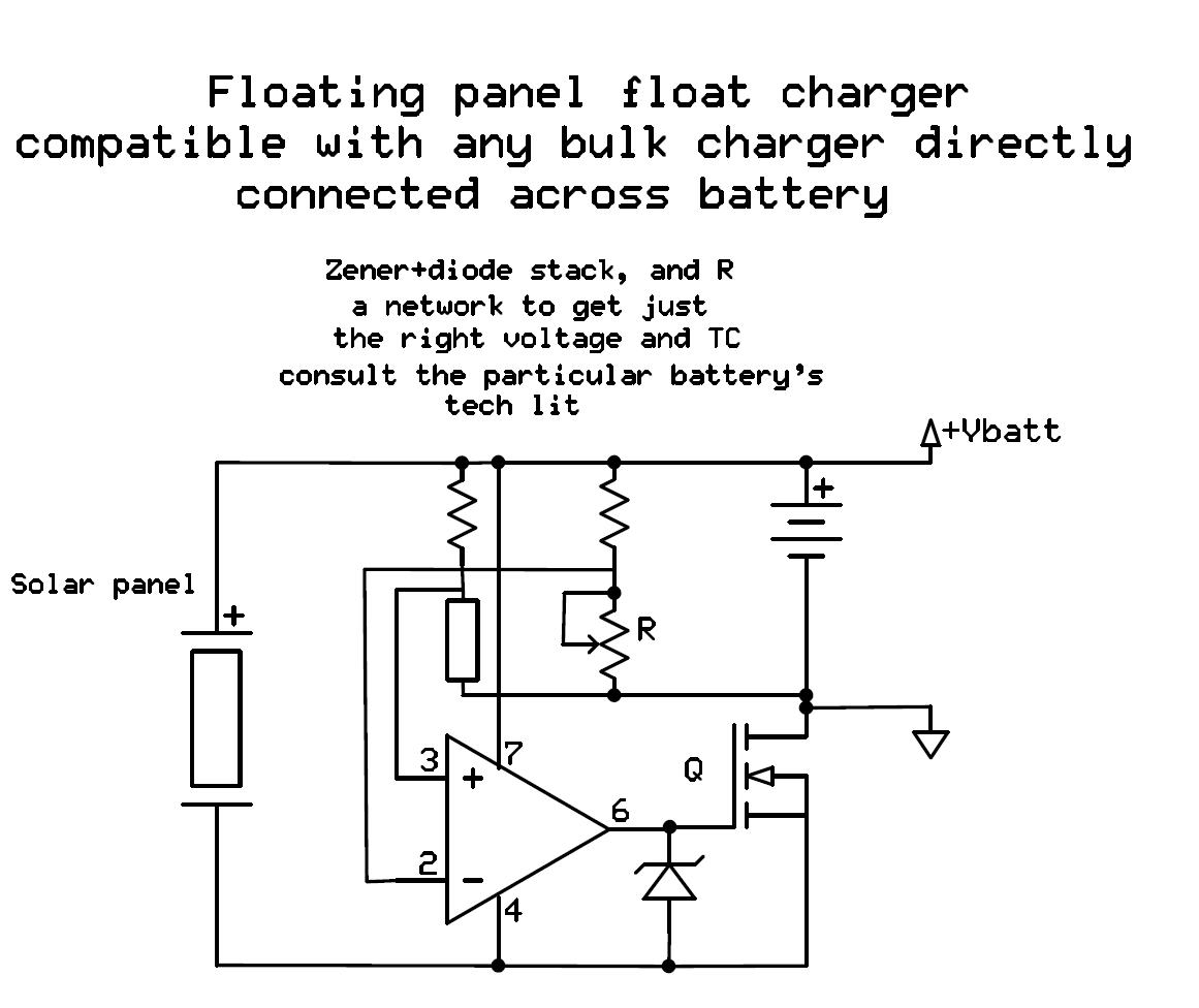

This is my float charger, the idea is to take an extra panel and connect it this way and just leave it there all the time. This way if you leave, turn off your normal charger, etc. you will always float the battery at the right voltage. I have seen data to suggest 50mV off is enough to take “years” off of the battery life. This charger might need a shottkey to isolate it in darkness, without it you have a down to zero drop series regulator that does not need much heatsinking , this has worked untouched for 9yr. on the same set of 8 Trojan T105’s (series parallel to 12V).
I have not seen this type of series regulator, but have not published it because by strict interpretation I think it violates some local codes. A case of where it does not matter off grid.
EDIT - The panel is not wasted in normal operation, under low battery conditions it kicks in and adds its current to the bulk charge no matter what the source.
