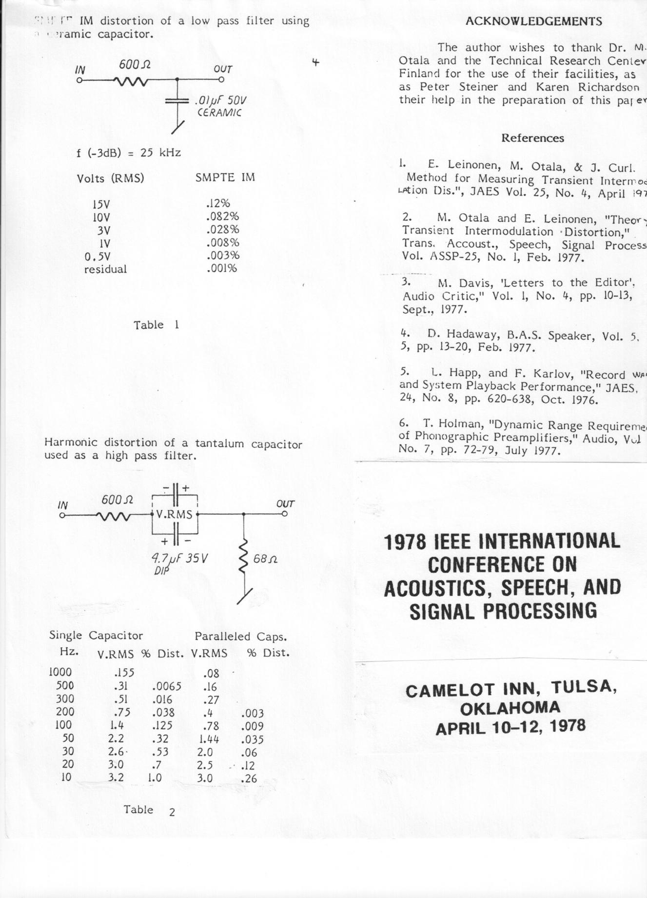

I went on record 30yr. ago as being uncomfortable with the DA articles as they were presented. I told John and Walt that the residual contained no harmonic distortions only the predictable frequency response deviations (often VERY small). The general lack of curiosity and desire to go further always disturbed me. Applying large AC voltage to bring out distortions on capacitors that see little or no AC voltage in the intended application is bait (Bate?) and switch IMHO.
Fortuitous coincidence based on second hand anecdotal evidence is neither science nor engineering. There was more that one case of "I can't hear anything, but every member of the GEB I ask agrees". As I said last week OK it's fair to throw out SMT X7R's, but take 4 or 5 decent film capacitors of different chemistry and line them up in a controlled DBT by DA (measured using the standard mentioned). The claims that Teflon clearly beats PP, etc.,etc. please substantiate them.

Have you EVER measured the harmonic or IM distortion in an X7R cap, marce? I have:
There you are again apples and oranges. An X7R bypassing a larger cap in a power supply sees virtually NO AC voltage at audio frequencies, hence for the application at hand these measurements are not relevant. And in the second picture why not use 100uF if you want 20Hz, unless you are really pinching pennies. Now I see where Bateman got his cues, even though I know where he got his oscillator. 😉
