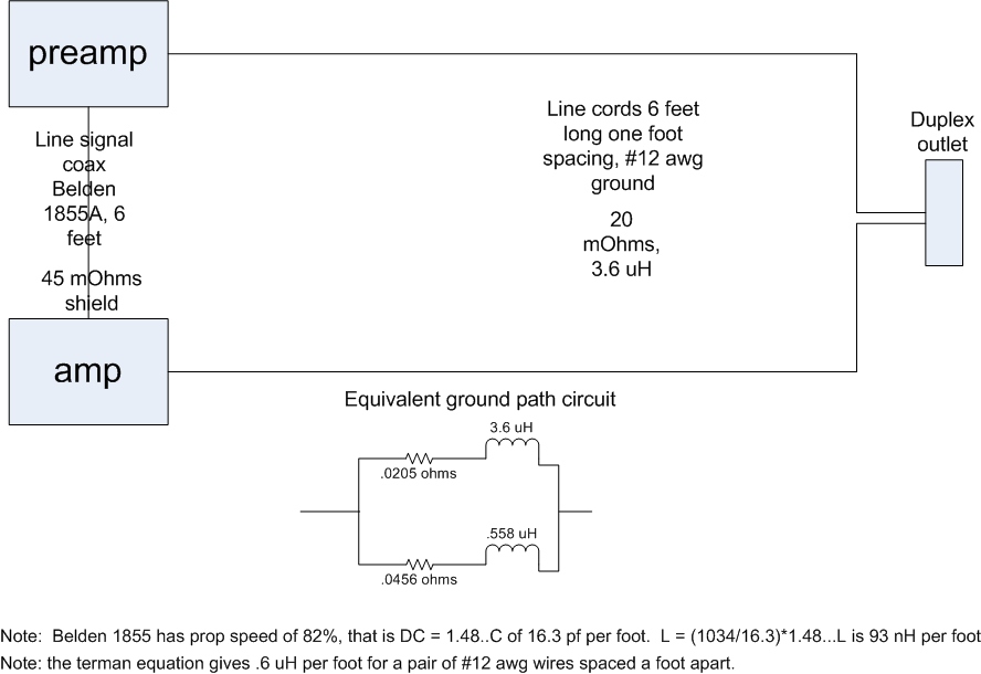

ARgggh...a technical question, and I failed to answer it...
Sorrry about that.
Here's the Q.
Ok, the discussion has been regarding the control of current..better stated, the control of current centroids.
Given a source of signal and a load of signal connected by coax..
The only path for the signal hot is via the core of the coax. Now, how does that current return to the source?
The thinking that it's just the characteristic impedance is not accurate at such low frequencies, it makes too many assumptions which are not correct.. At audio frequencies, we MUST be aware of other paths. For unbalanced audio with safety grounded chassis, we have a big ground path the signal can return via.
Think back to the PC board example I gave. At low frequencies, that loop will be exactly that, a loop. At high frequencies, the return current will be in the ground plane, but it will follow the top trace exactly like a stripline.
Now, repeat that with a coaxial cable where both bnc's are tied to the exact same wall of a chassis. At dc, the return current is via the chassis wall, and the signal is in the core of the coax.. There is a magnetic field through the coax loop, and a hall probe style clamp-on current meter will say that there is current flowing through the coax. At high frequency, the return current will be via the shield, and the hall probe will say zero. At low frequencies, you could make a loop of wire and tape it to the coax, and you will create an air core transformer, it will pickup low frequency signal. As you raise the signal frequency, the loop will pick up less and less as the shield current rises.
Now, let's reverse stimulus/response. If you have an external time varying magnetic field that couples to that coax loop, what happens?
At low frequency, the loop inductance including the chassis jack to jack path is high but the reactance is low, so an external stimulus will couple to the core wire and shield, but the shield wire cannot fully cancel the field because of it's resistivity as well as that of the chassis, connectors, and contact resistances.. At high frequency, the loop inductance is too high to support loop current via the chassis, so the coax is more effective at shielding, not needing the unbalanced shield current to buck the trapped flux in the loop. (I lament the discontinuation of IEEE-1050)
So to answer your question, you have created a frequency dependent current centroid path. It will depend on the shield loop resistance, the resistances proportionality, and how the test device handles the distinction between current flowing through the shield, and current flowing through the chassis. You have no control over the frequency break points in switching from cable to cable.
As I recall, you also mentioned that you used a capacitor shunt to ground at the output jack to reduce the harmonics through the test cable, where did that current go and how did the equipment handle it?
ps..I've added a simplified ground loop depiction, showing how one can calculate the break frequency for the ground current. Of note is the safety ground is very heavy, and will carry a higher proportion of current at low frequencies, while at higher frequencies, it will tend to go through the IC.
