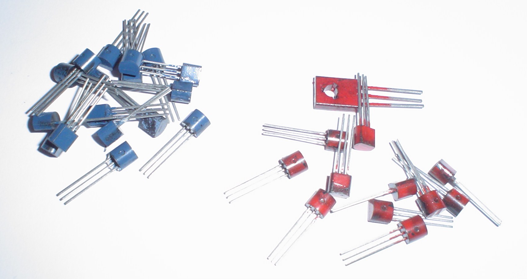

One engineer who worked for my father was red-green colorblind. Not at all good for resistor color codes.
Later, to help get the right transistors manually inserted, the incoming PNPs got painted on the top of the TO92 case with red nail polish. When I designed something with JFETs (very much unappreciated by production) they got painted white or blue depending on the part.
Black is sooo passé.
