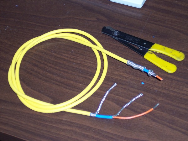

For old style chips with aluminum bonding pads on the top surface, the pads are connected to the leadframe terminals via a wirebond, either aluminum or gold. This wirebond is looped a bit so as to not touch the edge of the substrate in it's travel to the lead. Back in the 80's (IIRC) it was determined that the parasitic inductance of the wires (14 nH for some reason, comes to memory) significantly affected the speed that could be attained for all I/O lines of the chip. Also, two parallel wires can also crosstalk.
The basic issue was the slew rate of the current, how it coupled to neighbors, how it affected the speed of the signal, and for hot and ground runs, it can introduce unwanted ground or rail bounce.
At lower frequencies, the slews are not as bad, so the parasitic inductance doesn't have as great an effect.
Nowadays, the problems I see in things like the one chip amps, is the proximity the rail currents are to the input nodes. Any proximity coupling from either rail to that node can introduce error signals at the input pair, where gain is full.
For a one chip amp, I would make sure the supply rails have a common centroid...return, plus, and minus. See attached..a pic from 2006. Home made triaxial cable.
j
