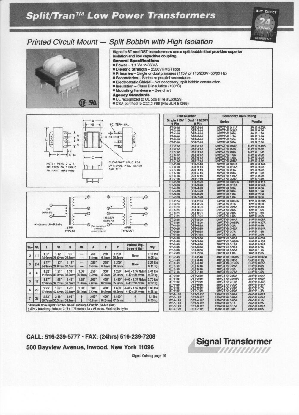

Bonsai, you mean well, so I will explain. The split bobbin low coupling capacitance transformers that we use, do NOT have or need a screen, because of the large physical spacing between primary and secondary.
The Harris hi speed-soft recovery diodes don't appear to need any snubbers, but I would not question someone adding them.

What we used. I hope it explains a few points.
Why not the dual split bobbins?
se
if you mean "semi-toroidal" C core with "balanced" dual pri/sec bobins on each leg they actually have higher pri-sec C
Well, U-U core as I understand it, but yeah, those. While I can see that they'd have a bit higher interwinding capacitance, they also have a bit smaller radiated field as far as I know, which has its benefits.
se
I just checked a power supply design I'm working on with one of those types of transformers for capacitance from primary to DC output: 38 pF. While a double shielded transformer can be lower (.001 pF for a Topaz) it only is if you can really manage the shield connections optimally. 38 pF is low enough that the cord orientation may be a bigger problem.

the high isolation double shielded transformer .001 pF spec can be misinterpreted - relies on your having gnds for the shields that you don't mind rather large parasitic winding-shield C, quite ordinary or slighlty larger shield-shield parasitic C too
John, the Signal Splitrans are nice transformers. I used them on an intrumentation product when I worked in the USA 25 years ago, although on recent audio projects have gone with Amveco. I would concede that the Amveco's have higher pri-sec C, but they are mechanically very good and low profile. Agree with the snubber comment.
