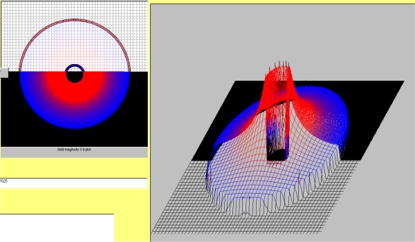

Look at my avatar, it is a field intensity map of a braid conductor inside a braid conductor... note there is no internal field to the inner braid, and there is none outside the outer braid. Energy is confined to between the braids.

Now we know where your avatar comes from, it would be nice to see it blown up a bit larger, could you post it?
vac
no prob.
It scanned the field, calculating the total magnetic field at every point. The left is the top view, the right is a pseudo 3-d pic, height corresponds with magnitude, scale is black to blue to red. The first pass scan is every 20 pixels for a quick view, then a full pixel to pixel scan to fill in the picture. The full scan took a long time, it was on a Pentium 150.

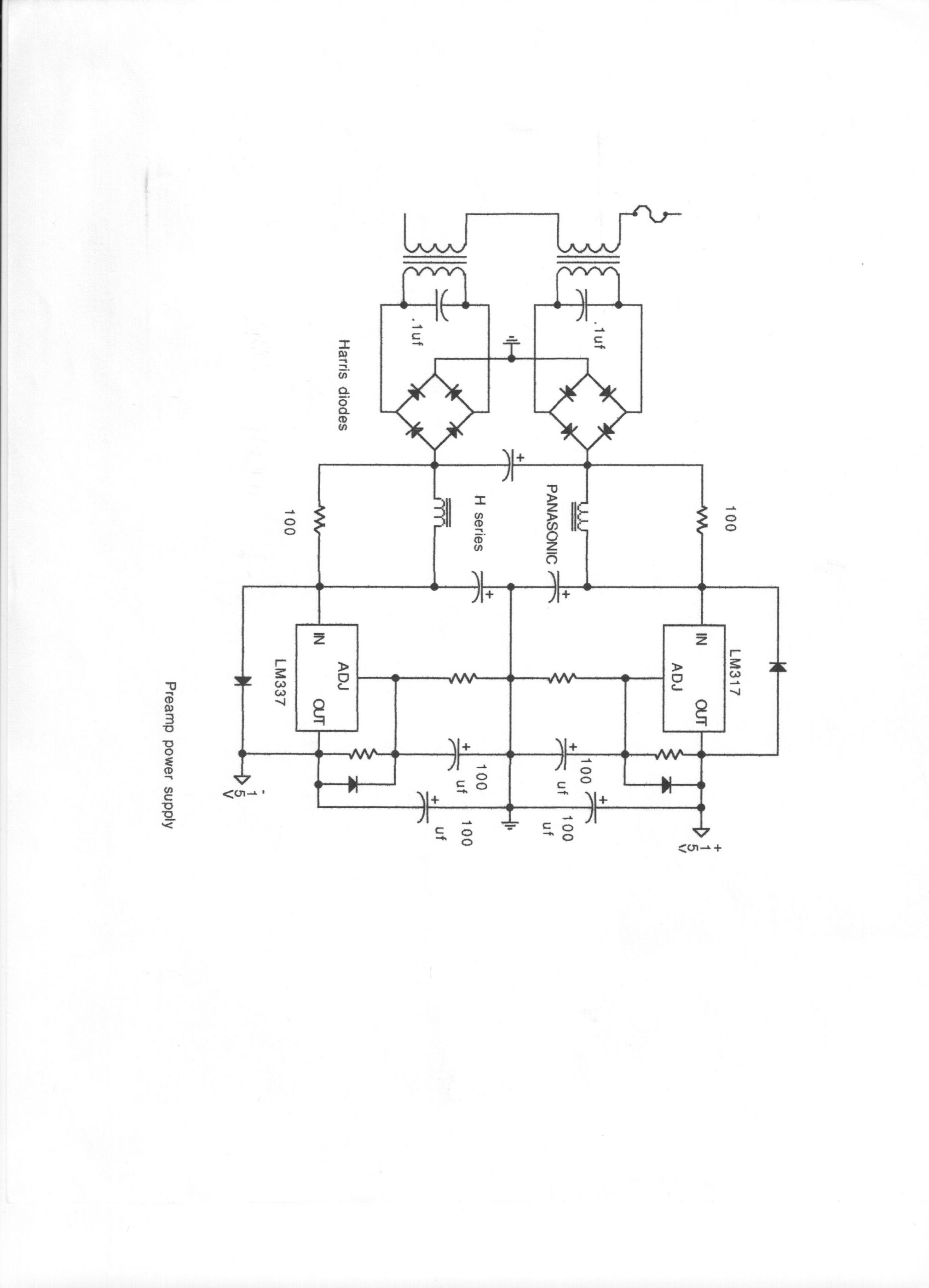

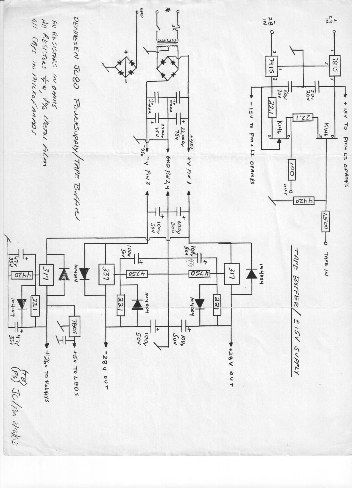

My contribution: I hope that it answers a few questions. It is not the complete CTC Blowtorch power supply, but it is close enough for discussion.
Hmmm, looks like the heater supplies in my phono stage. Happenstance, coincidence, or enemy action? 😀
Are the primaries really in series? Anyway, the interesting parts are never shown in most schematics, the exact "how" of the grounds.
Thanks,
Chris
Thanks,
Chris
Chris, it is the SCHEMATIC DRAWING PROGRAM that limits me to showing it this way. It is ALL one transformer.
As you may see, on John's picture "Ground" signs are misleading. Minus from diode bridges should never ever go to ground. It must go to first filter caps. However, experienced engineers know that intuitively without paying attention, so such "too schematic drawings" are common.
MY power transformers don't NEED shields! ;-)
I see now why you don't believe that power cords don't matter for my amps! 😀
Even sectioned transformers benefit from shields between primaries and secondaries.
The front end I use for my PS uses much the same lay out. One thing I found really makes a difference is grounding points. One might be tempted to take ground from the diode bridges and then run it straight through to the 317/337 with associated passives. John shows what I measured to really make a difference. Make separate grounding points at the diode bridge and after the 317/337.
