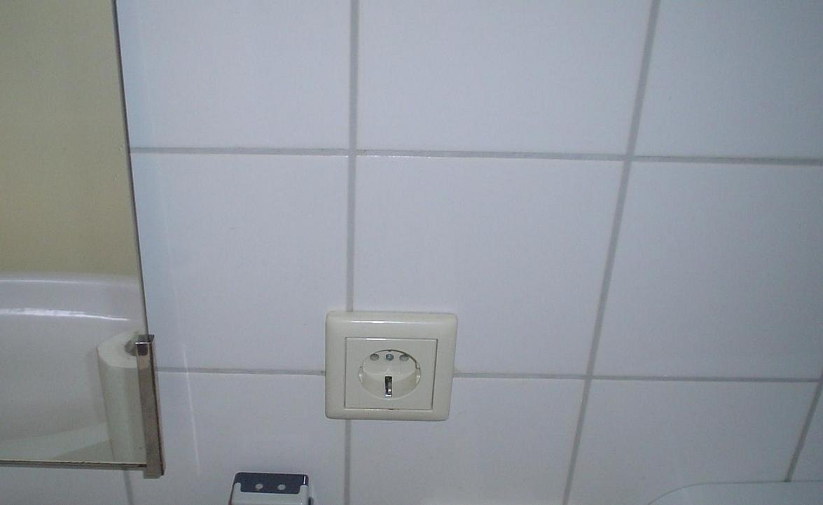

1st (ground) floor bathroom, completely redone by a pro contractor ~5 years ago.
Earth net under the floor tiles, everything grounded, including the automated rinse & blow-dry toilet seater.
(2nd and 3d floor bathrooms are fully grounded too, combined electrical floor heating and earth net, with a connection to a GFCI, did those two myself)

Jacco who makes the toilet seat? I need to check my wiring is GFI back home where I tapped in!
