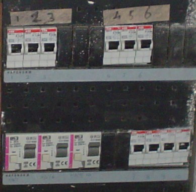

Image of the electrical panel in my home (barn and swimmingpool have a separate board)
16A circuit breakers, each group ( 2 of 3, 1 of 4) connected to a ground fault circuit interrupter (bottom left, 30mA types )
