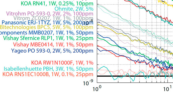

Back to resistor noise – for measurments clarification – I sorted graphs on p.10 of article you linked with illustrator. Now we can spend less time guessing… (attached is only cut-out preview, the graphs are here).I repeat this exhaustive survey of excess noise, plenty of choices (if you can sort out the colors 🙁).
https://dcc.ligo.org/public/0002/T0900200/001/current_noise.pdf
Thanks, that was nice of you.
