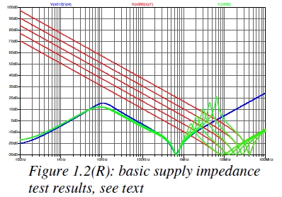

Yes, a single cap may have a specific resonance peak (in fact all caps have that).
The purpose of the additional parallel cap is to lower the first resonance peak, and replace it with a lower one (at higher freq). Then you use another parallel cap to lower THAT resonance and replace it with a lower and higher freq one etc.
But you must know what you do, you must know the parasitic resistance and inductance of the various cap types of course.
If you are interested in this, there a set of very nice articles with graphs on my website by Kendall Castor-Perry (aka the Filter Wizzard).

The rule of thumb has always been, from my memory, a 10:1 in uf value differential, on the film bypass, in order to avoid 'can' resonances building up, in the harmonic sense.
Bruce Moore was seemingly quite good at getting that done correctly. however, even as good as it can be, many have moved away from bypass -entirely.
However, that solution has not always been perfect, as we are back to the original problem, but at least minus the noise of the given solution. The only good part, is that knowledge and recognition of the sonic issue moved the pile forward one notch, via recognition of the audibility of the cure being worse than the problem.
We get a darker sound, but less disruption in harmonic structure of the music signal amplified or whatnot, and thus the music moves people's butts far more effectively.
If using a large bypass due to PS line lengths, a high value (+20uf) EC 5mp12 100vdc film cap (or similar), right on the transistor's rail input leg, works quite spectacularly. No solder, no traces, nothing. metal to metal (anchored by solder), right at the transistor body itself. Lowest impedance pathway that is practical and/or possible. Works for me!

I was for the most part agreeing with you, my only real point is that the by-pass needs to be designed.
If you want a certain minimum impedance then you have to go through the design process to achieve it. This includes taking into account the parasitics and insuring that no resonances exceed the minimum.
A measured response would be required to validate the models and process used.
-Antonio

The problem with rules of thumb is that nobody knows why, even if its a wrong rule for the occasion.

If you feed your power supply through a 50 ohm resistor and then sweep the frequency over say 1k to 5MHz, you may well be able to pick up the resonances. Another option is to feed in a square wave and look for ringing. 1-2 volts is enough and do it directly into the cap bank- ie after the rectifier. If you have a network analyzer, even better. Just for reference, 1cm of PCB trace is c. 10nH, so there's plenty of scope for problems.
