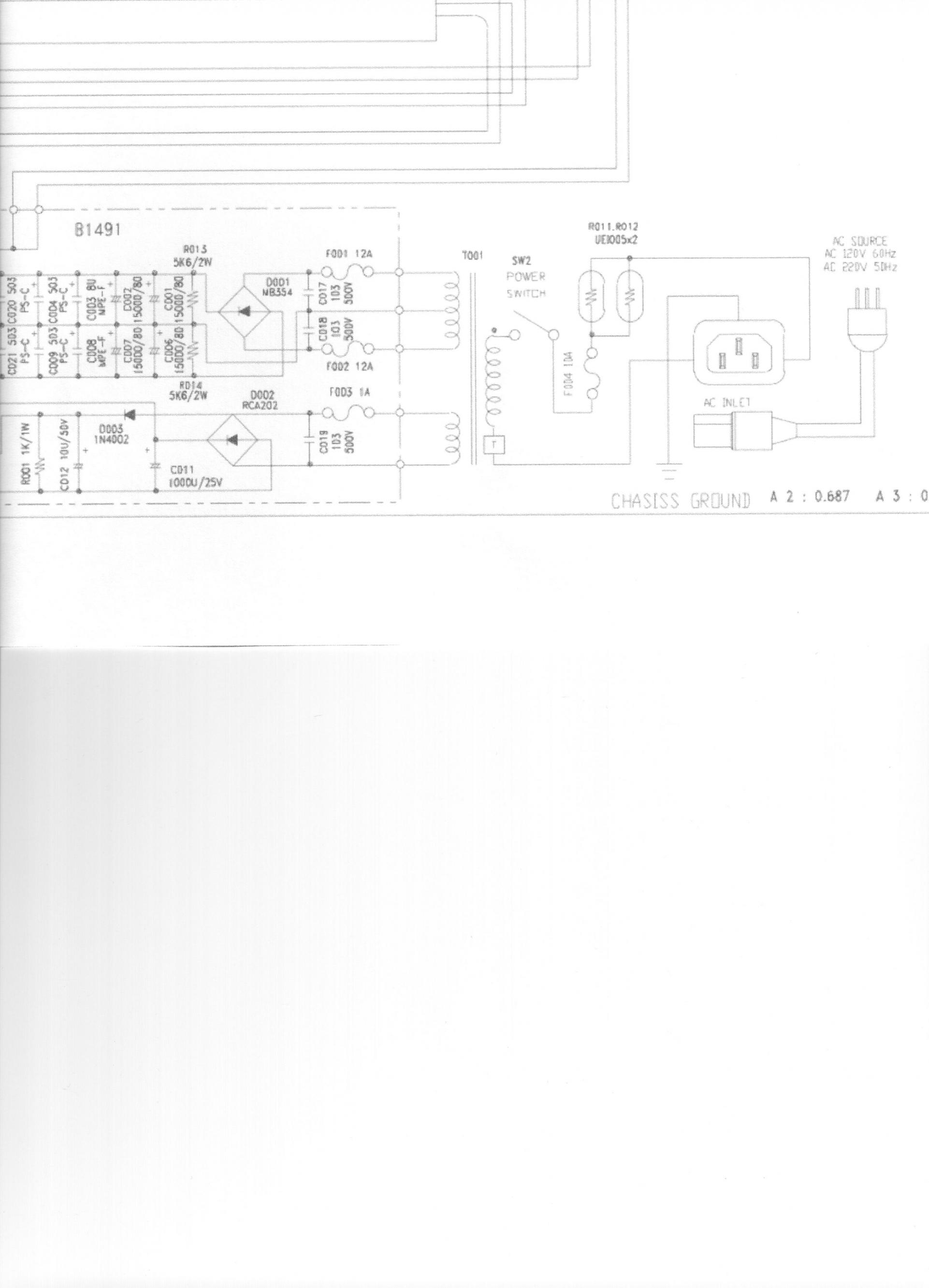

Now to complete my DIY modification of the HCA-3500 into an 'A' quality amplifier.
Let's look at the power supply again. Then remove the non-linear resistors at the input of the amp, replace the power switch and fuse, with a circuit breaker, instead. Substitute aluminum for iron top cover, etc. That is 'all' there is to it.
Non-linear resistors at the input- are you referring to the NTD in rush limiters on the transformer primary here?

I like to keep real fuses, with good holders they are preferable to circuit breakers. But both are good options.
I would also leave the NTC's in place, but instead bypass them after power-up using a whopping big relay.
There is one more item you do not mention.
IMNSHO the protection circuit should be changed with a muting relay on the input (or possibly a shunt at the VAS output - collapsing both the VAS output to ground and thus also collapsing the output stage Bias) handling overload and a crowbar relay handling output DC protection with the input mute relay being "OR'd" with that.
As the Mute relay will be a small signal one it should engage faster than the output crowbar, so if the DC protection is triggered by bad signals, DC on the input etc. the output short circuit will have nothing to "short" out, so if the Amp is not already fatally damaged it will do nothing.
And if an output transistor (or a bank) has gone south I do not trust the usual output relays to reliably interrupt the current instead of arcing over and welding shut (I tested that in the 80's). So a crowbar with mute is the correct way to protect speakers from blown Amp's.
In my current day Amp's the power to the mains transformer is under software control, so in case of DC protect engaging (which takes one of the two interrupts - remote is the second on the MCU) I also switch off the power to the output stage... And yes, they include mute at the power stage input and a crowbar on the output.
From a sonic viewpoint it gives you a straight line to the binding posts, no relay contacts, which can be between okayish and horrible beyond belief.

I would also leave the NTC's in and then short them out with a relay. The other alternative is to replace the NTC's with a suitable high power resistor, which is then also shorted out with a relay after the filter caps are charged and the mains transformer in-rush has passed.
This has been pretty standard technical solution for at least 20 years 🙂
Well, everyone, although we still had a questionable circuit board layout, and a marginal power supply turn-on solution, we made a pretty good sounding power amp about 12 years ago that we could take to CES with pride. I don't expect everyone to follow our example, in fact, you would be wrong to do so, BUT the SPIRIT of the changes, including simplifying, better parts quality, wiring, and non-magnetic connectors, high speed diodes, etc, etc, should be considered, if not followed.
While I appreciate any constructive criticism, please don't presume that I don't know a potential problem, such as removing the non-linear resistors on the AC input, instead of adding a relay. We got away with it, however, at the time. Later we added the relay.

The multiple fuse (eg, 3x times 3.3A fuse, instead of a single 10A fuse) trick I proposed works quite well, when it comes to linearizing the (as perceived-by ear) damage that fuses do to dynamic draw considerations. The requisite protection still exists, it is just that it is more linear under dynamic draw. Thus making the fusing more sonically 'palatable' to the ear...

I agree with all these changes. I keep some extremely strong ND magnet around, to test parts for magnetism, with it you can "feel" if binding posts or RCA's have nickel plate in them (this is a VERY dangerous magnet BTW, get your finger between it and a steel plate and you may loose it).
John, the suggestions where not so much offered so much to correct or help you (we know you know), but to offer solutions to the community, in support of your work and contribution.
