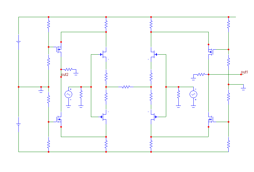

IMO it is high time for the CIRCUIT again, some might have forgotten and some might have never known 😉
Well, the 'chatter' has decreased, so maybe we can get something done.
What PMA has brought up and emulated (far better than I ever could) is the basic topology that is used by the Blowtorch preamplifier, which in turn, was a adaption of Charles Hansen's Ayre topologies, and inspired by the 'less is best' tube line stage developed by Art Ferris.
Now, many here will wonder why I might give so much credit to others for something that I am known for, namely balanced comp-differential fet designs. Well, my last design effort of major proportions stopped after Vendetta Research closed shop in 1992.
And at that time, I worked part time for Audible Illusions as a consultant, so I got to work with tube products for a period of time. Also, did some extra measurement of the open loop line stage that Art Ferris developed, using a parallel version of a single tube.

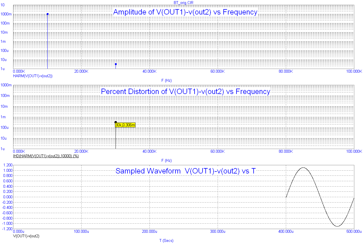

When I made the extended distortion measurement, more than 20 years ago, I used a wave analyzer on the distortion residue of an HP339 HD Analyzer, while measuring the line stage at some 'reasonable' output. I found very little, but 2'nd harmonic, maybe a little 3'rd, but nothing else within my measurement limit, at the time, which was perhaps -120dB down. I was impressed! NO single solid state device, running open loop, could match that. It seemed that that tube topology could not be copied with any real success in a solid state product. Perhaps, it is best to try a more sophisticated topology, WITH ESSENTIALLY THE SAME THRU-PATH, in order to get similar subjective results.
The first option, of course is the differential pair. The second option is the complementary differential fet quad, with AC coupling with 4 output caps, 2 summing for + out and 2 summing for - out.
The third option was to use the folded complementary differential cascode, much like Charles Hansen uses with his designs, to remove the output caps and the resistor loading distortion generation from having to use load resistors with a relatively low voltage power supply voltage for practical reasons.
This we tried, and this we succeeded in.
Of course, there were a hundred other problems and design decisions that had to be made, but in principle, we had a direct coupled in-out, open loop, differential or single ended in or out, so a selection of balanced and unbalanced configurations could be easily used. Our thru-path was at minimum, one comp cascode to an output, worst case was a differential fet pair and cascode to an output. About as minimum as I can get, and still get reasonably low distortion, open loop.
Superficially, there appears to be little difference between the JC-80 of 30 years ago, and the Blowtorch, but there are many significant changes in the 15-20 years that occurred between the original inception of these 'all out' designs. They are just more subtle to most people.
