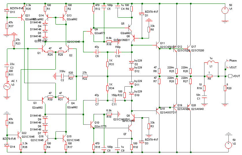

They'll work with Vcb=0, but it would be better to put something (diodes/LEDs/other) between the emitters of Q6 and Q9 and the rails to provide some extra voltage drop. Especially if the mirror is degenerated, as it should be.
You could put small signal diodes in serial with the relevant
collector of the current mirror , this will increase the VAS
base voltage by 0.65V and allow to degenerate it with enough
voltage drop in the degeneration resistor to provide DC current
stability.
Problem , wich already exist without those diodes but in a lesser
extent , is that the VAS base emitter capacitance cant be
discharged fully.
Sorry, I don't follow. Where is gain being lost?
A saturated transistor is not much of a load for the input jfets, to rely on any significant open loop gain in the input stage. To add insult to injury, probably most of the harmonic distortion cancellation due to the current mirroring effect is lost.
The feedback loop(s) are loading the VAS with about 550ohm and if you consider 100 ohm emitter degeneration it won't allow a VAS gain over 11 (550ohm/50ohm).
One to another the open loop gain will be low, probably under 20dB at LF. Output impedance is 50ohm, nothing to call home about. Also, your VAS bias is dependent on the jfets Vp, which in turn is temperature dependent, has rather large device and batch dispersion, etc...
There are ways to make this topology work properly, but nothing that would not further add to the complexity (or further trade the performance).

I am again really surprised on how much confusion this topology is creating. No, I don't your topology would work outside the simulator, other than by accident, and with the known thermal issues.
Can you tell, by inspecting the schematic, how much is the voltage in the Q9 base? Hint: no, it is ill defined.
At least, Godfrey schematic tries to define the VAS bias by using the input stage differential bias voltage (about 2Vp) divided by the VAS collector resistor. This one is, bias wise, practically identical to the Slone's fig 11.4 famous blunder.
The confusion is in your brain , firstly...
Any moderatly trained eye will tell you that Q9 base voltage
is the sum of the diodes losses + Vce SAT Q9 + 1/2 tail current x R1.
Since the higher base voltage allow energic degeneration at the VAS
emitter , any CM unbalance is easily corrected by the global NFB
without unbalancing the VAS differential current.
Without this heavy degeneration the VAS current will be unbalanced
as a side will enter full conduction while the other one will be almost switched off.

You are putting the diodes into the wrong line.
Let the CM Transistor carry the voltage, it needs it for high impedance (I'd say give it at least 3V), put extra diodes in line with your VAS to up voltages if needed...

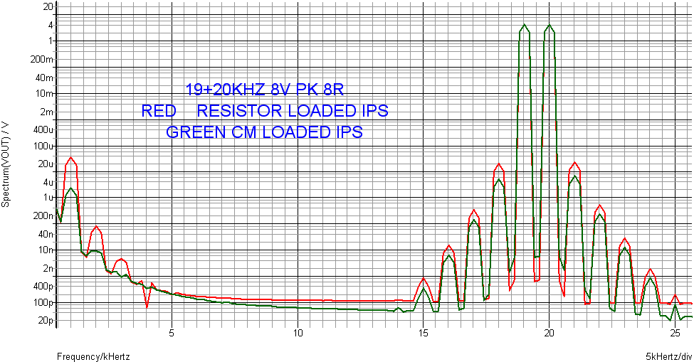

There s some advantage in implementing them this way...
The IPS has way better linearity with a CM , that s not onlyNow past that, the only reason to use CM on the IPS is to maximise looped negative feedback and to maximise the impact of the non-ideal behaviours of the next stage on the systems linearity.
Someone please remind why exactly would I want to do something so monumentally devoid of intelligence, apart from DS's say so?
CM load has it's uses and places, but maybe not there...
a matter of NFB maximization.
The reduction in IMD that it allow is simply stunning.
