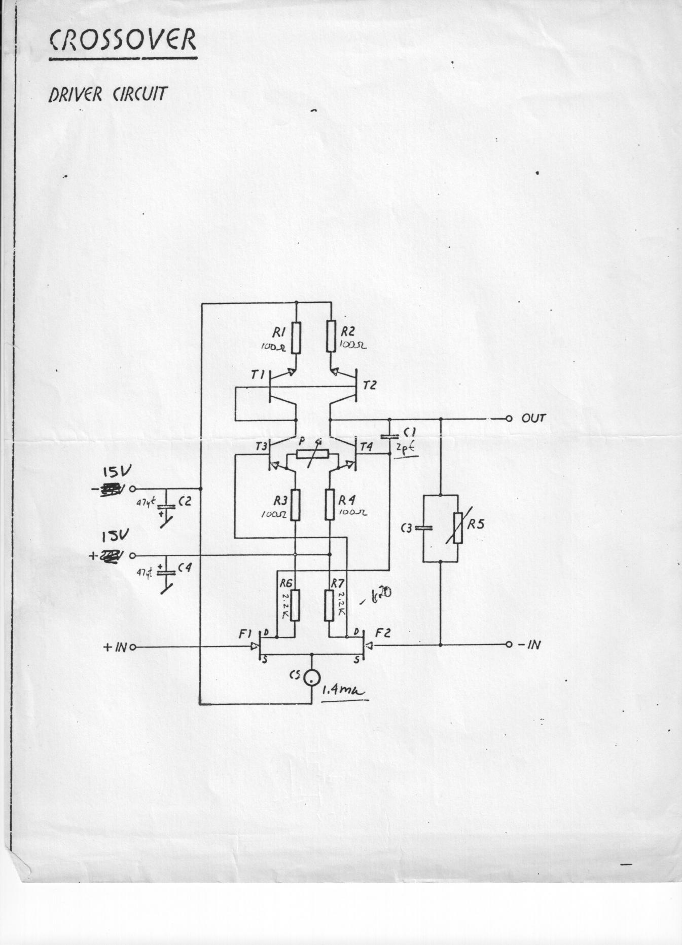

Yes, my mistake. The feedback network resistors should be much higher if they are directly loading the VAS.The feedback loop(s) are loading the VAS with about 550ohm...

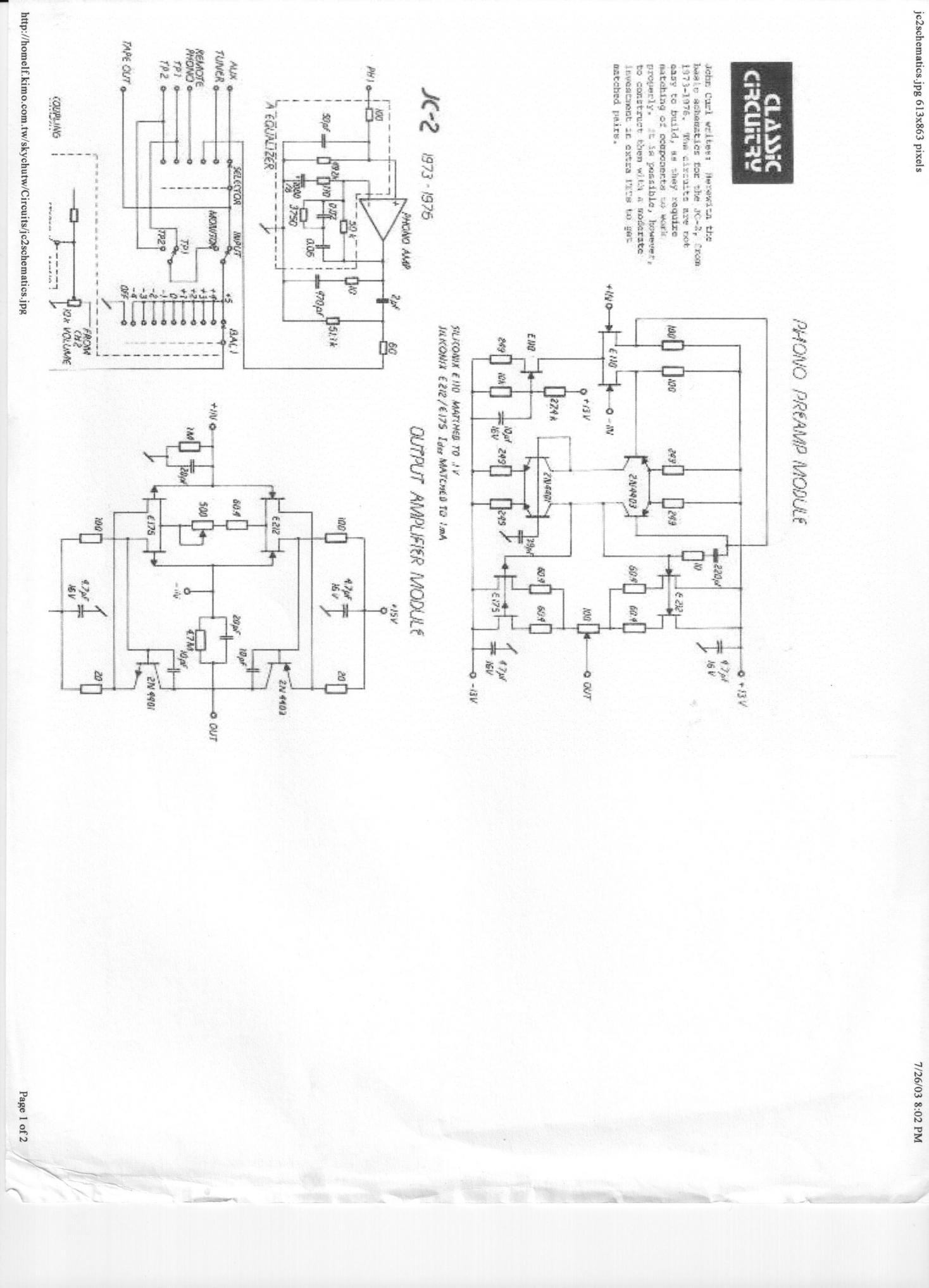

This design was predated by the phono stage of the Levinson JC-2, and before that, a hybrid design by Dick Burwen for Analog Devices in about 1966.
This is a simplified version, or what I called a 'kernel' at the time, to simplify the series thru-path and get a good slew rate. Both the jfet pair and the complementary bipolar quad that were used were American based, because the Japanese had not yet introduced their more exotic devices to the USA at the time (1977), in fact they may just have been on the drawing board.
Now, what is the 'advantage' of this sort of circuit over a good IC, especially at the time that it was first used? (1977)
First, the circuit has to operate Class A, so it removes any crossover distortion.
Second, the circuit is fast, perhaps 50-100V/uS, because the additional compensation is minimum, to make it stable.
Third, it can be very quiet, especially with the later offered Toshiba jfet pairs.
Fourth, it has a MINIMUM thru-path between input and output, and virtually no input bias current.
etc.
Now, what are its limitations? Without a cascode on the input stage, the design works best between +/- 15V to 20V.
The device CANNOT drive a 600 ohm load, because the peak current only 5 ma or so, and the open loop gain will drop drastically with a load less than 2K ohm or so.
The layout takes somewhat more room than a typical op amp.
Still, this is one of the best 'compromises' that I have come across, and properly utilized, it will sonically 'beat' just about every IC op amp that is out there.

This is a 35 year old design that was originally made for the Symmetry Xover.
John,
What is Symmetry? I haven't heard that name before, except you mentioning it a few times? Is it some company or was it a code name for one of your projects?
Why I'm asking? Take a look at this gain block from crossover by (now giant) Japanese company that hit the market around 1978. The similarity is stunning. Unless you were working for them, that's ....

The Symmetry Crossover was well known in the USA, and founded by Noel Lee, of all people. He gave it up to do Monster, after a few years. I do not specifically know this manufacturer, unless they are associated with HK in some way, who I worked with at the time.
I do not specifically know this manufacturer...
John,
It's a SONY !
That gain module is from their top of the line crossovers TA-D88 and TA-D900.
Sony TA-D88B on thevintageknob.org
Sony TA-D900 on thevintageknob.org
I studied a lot of Japanese amp and preamp designs in the early '80's. We used to have "Musen to Jikken" and "Denpakagaku"(?) magazines going back to 1977 or so in our library at the company I was working for. Those mags published many schematics of comercial offerings, including exotic ones. Some of them used interesting, not seen before topologies. I always wondered who were the designers of these and thought that there must be some very good engineering potential and some very clever guys over there whose names we probably will never know.
Fast forward 30 years. Thanks to the internet and the amount of information available, I'm beginning to think otherwise. The picture becomes clearer now and small pieces of puzzle one by one snap into their places. I can certainly see now where one or the other manufacturer "got inspired" in the process of creating their own products. Hmm...
Sony also reportedly borrowed the Dayton Wright bootstrapped cascode input design. i wonder if anything of Nelson's made it into their product range as well.
It is difficult to say where each design came from. I was somewhat surprised on the similarity of the Sony schematic to my own, but we may have derived it from the same place, which was the Levinson JC-2 phono stage 1973-76, published in 'The Audio Amateur' by me, in 1977, once my royalties were arbitrarily cut off. However, it could have been completely independently developed as well. It is a rather trivial execution of a fundamental design 'subcircuit' that has been used by many sources, both professional and amateur.
