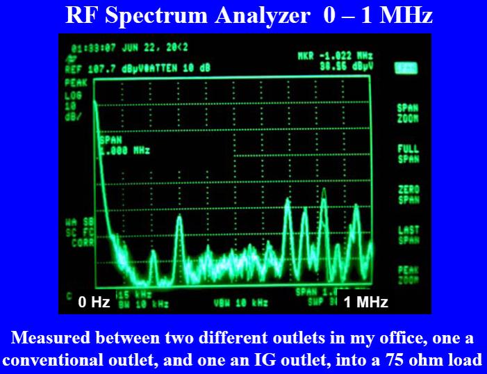

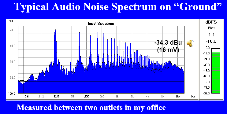

OK, by the same fellow, named Jim Brown, who gave a presentation at the 2008 Fall Convention of the Audio Engineering Society in San Francisco.
http://audiosystemsgroup.com/AES-RFI-SF08.pdf
Seems like a worthwhile presentation to have attended.

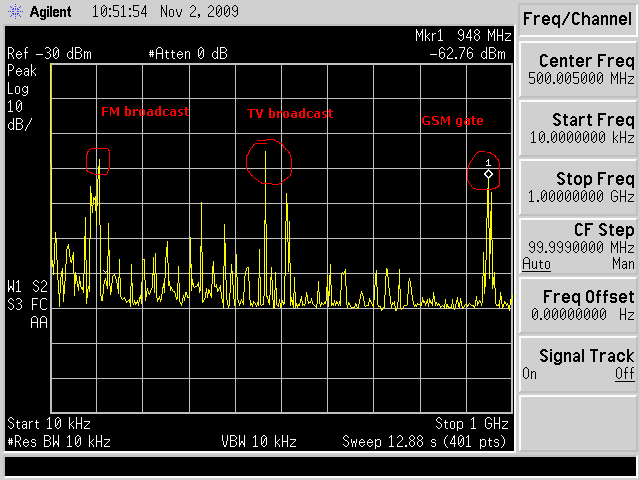

Yesterday I forgot to show the measurement extended to 1GHz. We can see FM broadcast, TV broadcast and GSM in the PSU output spectrum. Of course, the very high frequencies are coupled from the air.
I can see from your measurement that GSM, TV broadcast, FM broadcast, etc... do exist.
And what about the spectra from 10-20GHz? There are Ku band satellite DTH TV broadcasts there, high power transponders with 27 MHz bandwidth, carrying digital signals. Those are much powerful than the next GSM tower! Not to mention the evil Ka band at some 54GHz.
So? Should we get tin foil helmets? Should we encase our amps in Faraday cages?
