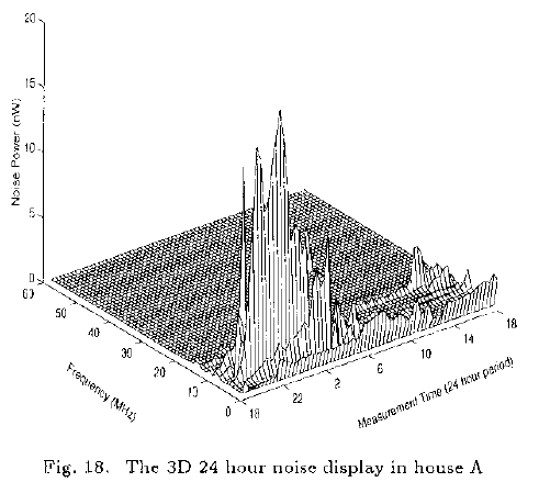

The paper is: 'Wide Band AC Power Line Characterization' IEEE Trans Consumer Electronics Nov 1999 pp. 1087-1097. Liu, D, Flint, Caucher, authors. ISSN: 0098-3063

let me ( as a very ordinary DIY audio builder with basic electronics understanding) - how do anything from 1Mhz to 200MHz power line noise spctrum go through the step down transformer ( with a very poor bandwidth - ) and how much of this noise coming in to the rectified filtered DC modulate the line amplifier signal? We assume that line amplifier has much higher bandwidth than 50 Khz bandwidth normal to audio. Do I miss something without going through this IEEE paper?

Yes. Kannan_S, you are missing something. Toroid power transformers pass the RF line garbage right through.

Also remember that even though a circuit may not respond past a certain frequency, the individual parts sure do! Even if they don't, every PN junction is an AM signal detector. Then, is if that isn't bad enough, various frequencies may mix with each other. The end result may be a collection of odd noises in the audio band.
Another effect may be that certain parts of a circuit may be operated at high enough levels to cause distortion. Once your clean audio signal arrives to this overloaded stage, it gets "bent, folded and mutilated" as well.

Anyway, noise on AC supply lines may or may not affect a piece of equipment. It really depends on levels, frequencies and how good (bad?) the shielding is. A simple power supply with poor HF shielding allows higher frequency RF to ride right on through.

Most high frequency noise will come through capacitively between the windings. Also, don't forget that once the noise is "in the box", even before it runs through the transformer, it may radiate out exactly where we don't want it.how do anything from 1Mhz to 200MHz power line noise spctrum go through the step down transformer ( with a very poor bandwidth - ) and how much of this noise coming in to the rectified filtered DC modulate the line amplifier signal?

now we have no answers to this - what frequency max and what amplitude of this range can cause problems in a line amplifier?
Can we assume that 3 mm Aluminium enclosure would adequately shield a line amplifier from radiating RFI? I am excluding Phono Amplifier or AM detector kind of circuits in this question. I also assume that PS line should get to the rule so defined for RF noise( If John can give us some guidelines on Freq/amplitude guidelines for PSU noise - will be nice?)

I am concerned, within reason. I don't think potential RF ingress issues require any special or outstanding measures. To my experience, common sense practices like good grounding, proper shielding, smart wiring (reducing loops), filtering, decoupling, ground loops (or lack, thereof), RF input filters, etc... are addressing 99.99% of the potential issues. No need to get paranoic about, and shielding audio gear like a RF transmitter, designing power supplies for tenths of MHz rejection, etc... is a waste of time, energy and money. Of course, there are always pathological cases like people living in the proximity of RF transmitters, but I don't think they should set a design target.
For example, while I absolutely agree that toroidal transformers are allowing some (?) RF ingress through the winding capacitive coupling, I have never seen any shred of evidence or credible study about the impact (and superiority, thereof) of (e.g.) R-core or even split bobbin transformers on the audio performance. Moreover, if such impact exists, the transformer is not necessary the evil part. To me, (e.g.) building a gain stage with virtually zero PSRR, then complaining about the transformer/power supply allowing RF ingress, is plain wrong design.
