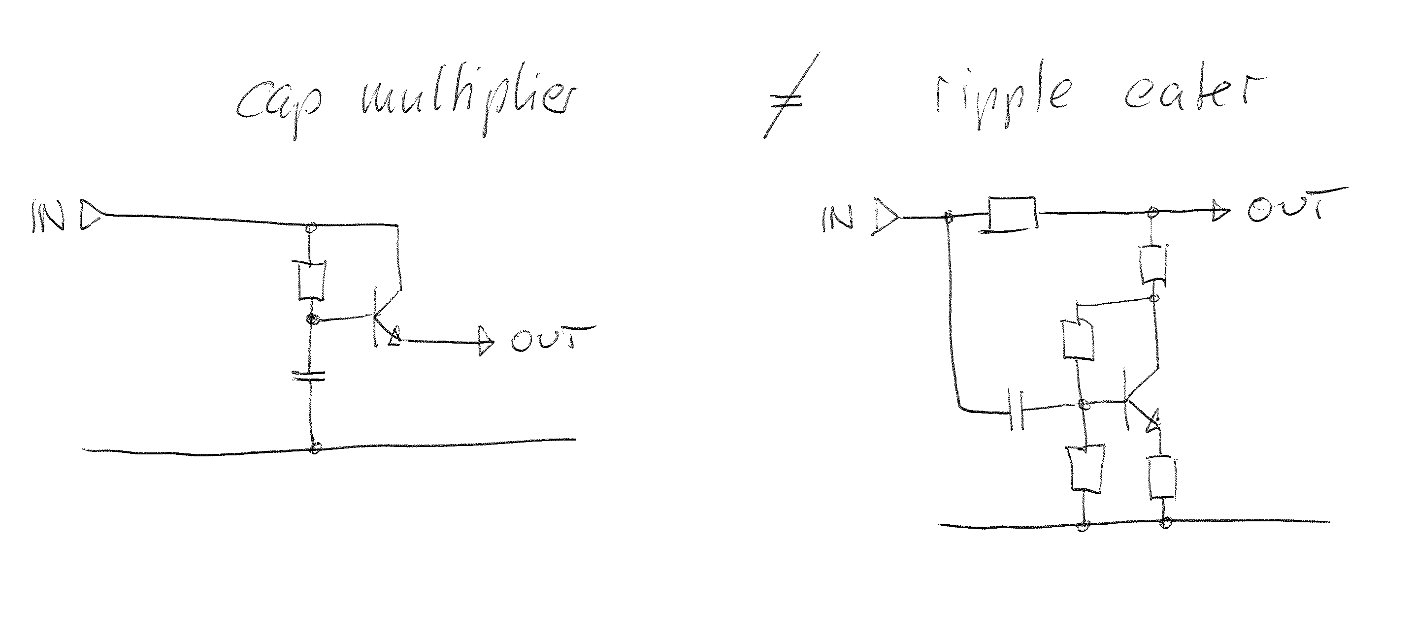

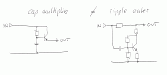

.....ripple eaters aka cap multipliers.....
Since I seem to be misunderstood.
A "ripple eater" is NOT a cap multiplier.
See what I understand as a cap multiplier:
Using a low noise transistor or JFet, you get very low noise at the output, of course at the expense of a not so low output impedance...
